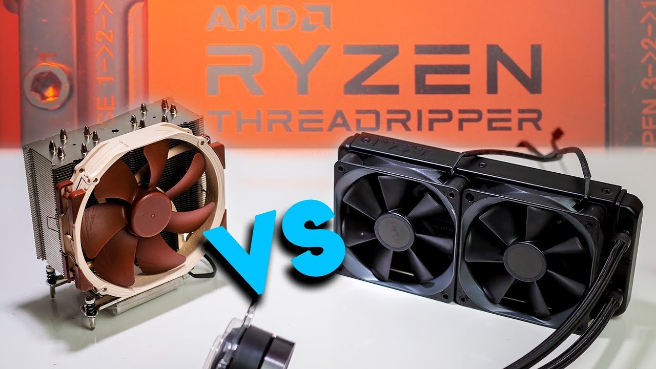

The Noctua coolers handily beats the Asetek CLCs with a round coldplate.

The TR4 specific Noctua beats the non-TR4 specific AIO when used on a TR4 processor. That result does NOT extend itself to when your talking about smaller sockets and cpu’s, such as AM4 and R7 1700. An AIO is still a better performer when we are talking about equally sized cold plates, as proven here in an OC3D article and video that compared the Noctua D15S (a bigger and better performing) version of the U12S the OP is talking about, against a selection of 240mm and 280mm AIO’s. Shocker, the AIO’s won.
https://overclock3d.net/reviews/cases_cooling/amd_ryzen_5_7_cpu_cooler_round_up/6
