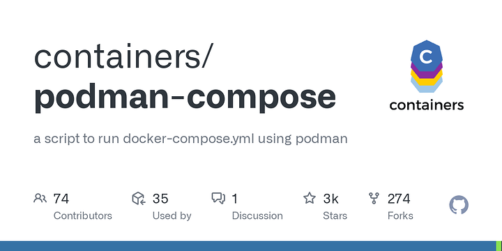

Since y ou’re planning to run Containers and are on RHEL, check out:
It’s also compatible with either Docker Compose:
or Podman Compose:
