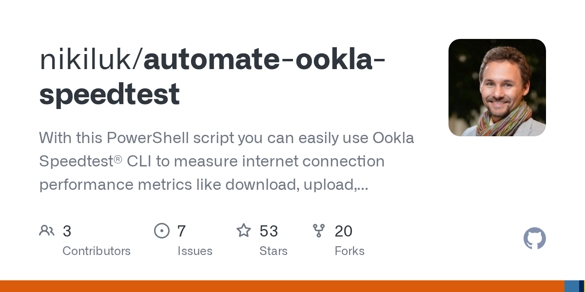

Guys, it’s 2022 … Have the damn computer wake up at 3am and run the test for you, while you are sleeping …
So set the PC for Wake-On lan, auto log the account and run the powershell script for ookla speedtest??
Leave it running for 24hrs running a speed test every 15 minutes?
