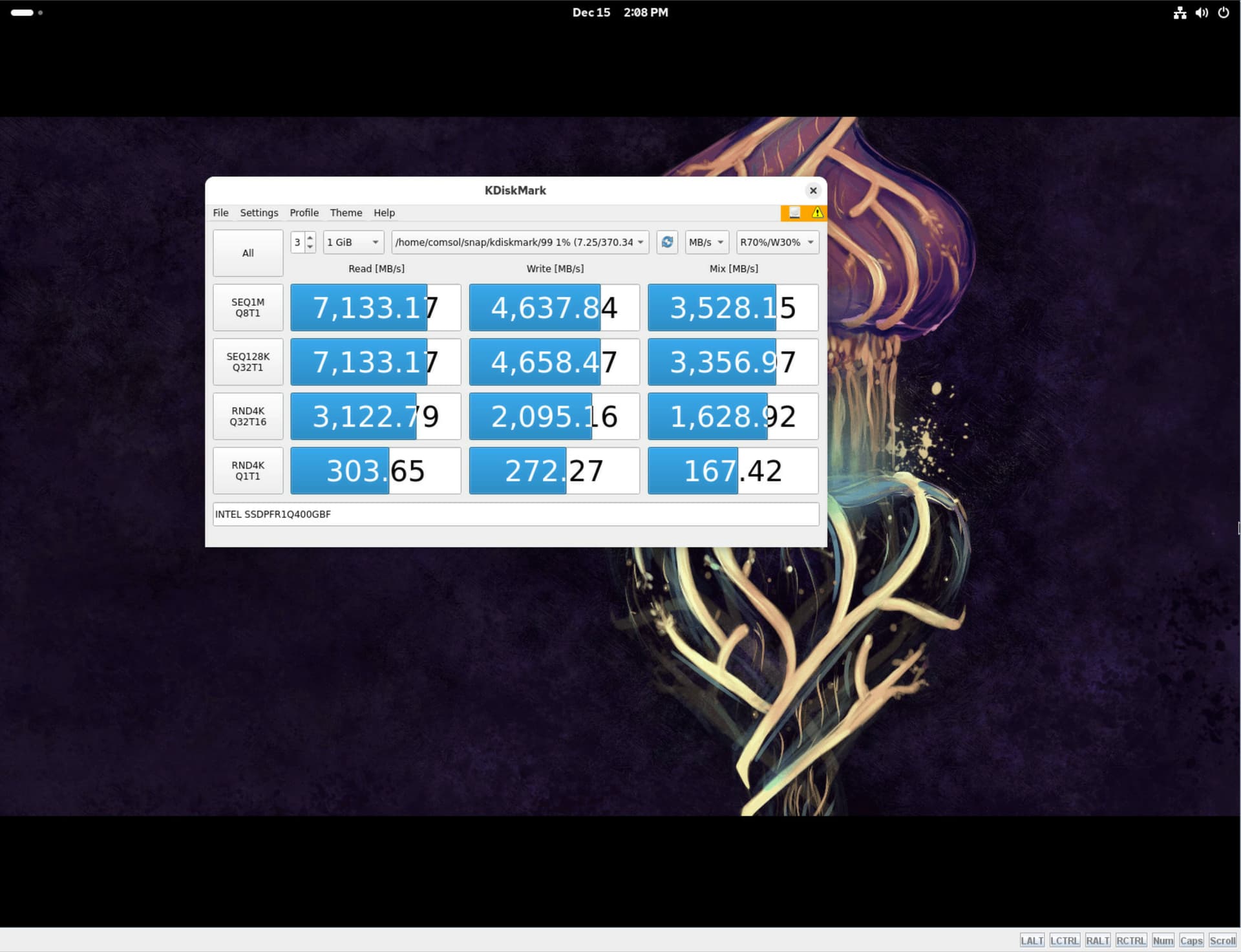

Here’s what 2 P5801Xs in mdraid 0 look like:
:thinking: For Optanes, 300 MBps Q1T1 4 KiB random read is kind of meh, which I’m assuming is caused by the RAID?
Yeah, I’m pretty sure the software raid is the cause of the mediocre performance, I’d expect it to be the same as @nathanr numbers without the software raid.
What’s interesting is how poorly the software raid handles mixed random low queue depth workloads comparted to 100% read or 100% write.

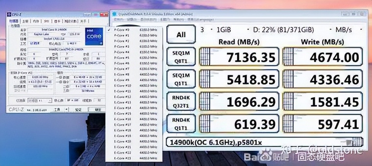

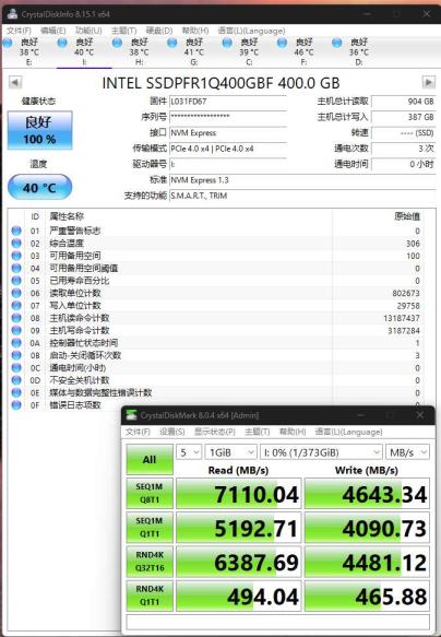

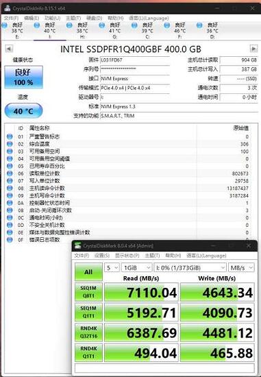

Two people who did benchmark it managed 619 MBps and 494 MBps T1Q1 4 KiB random reads in CrystalDiskMark respectively, which sticks out to me because I’ve not seen any this high before for CrystalDiskMark:
If Google Translate is correct, the random performance of this second generation of enterprise Optane is CPU-bound, as:
In fact, if the CPU frequency is further increased, the 4K random read and write speed of Optane P5801X can be even higher. In the SSD forum, a guy raised the CPU motherboard to above 6GHz and ran a terrifying result of more than 600MB/s with Win7 system
Perhaps that’s explains away some of the performance variations with Optanes. I get consistent 340-ish MBps benchmarks across both Optane generations with an AMD Ryzen 7800X that runs in ECO mode.
I ended up getting SSDPFR1Q400GBF1

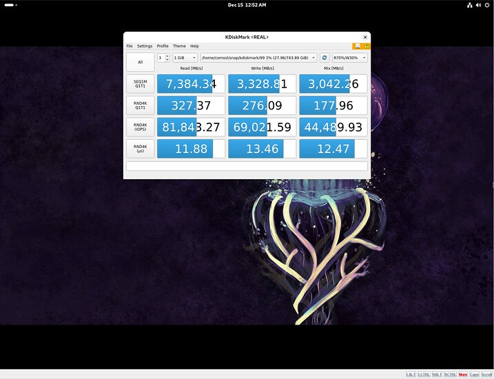

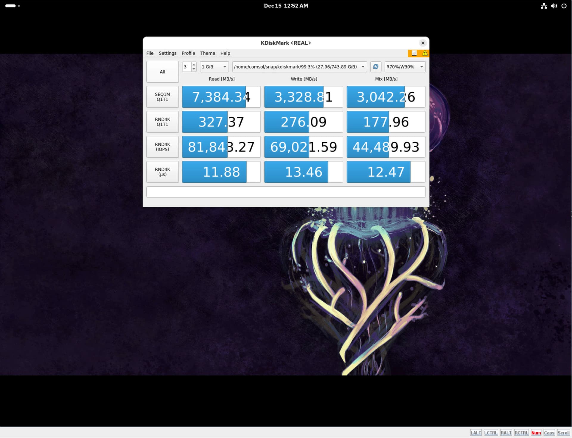

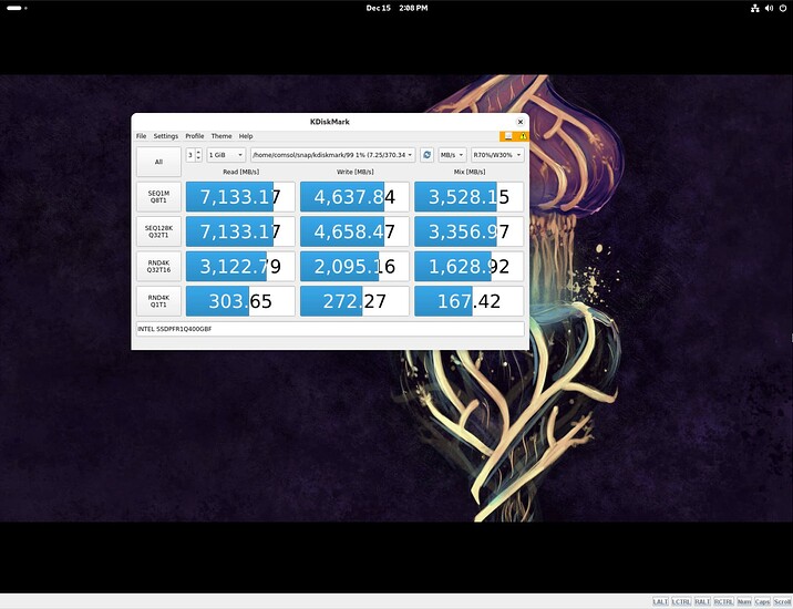

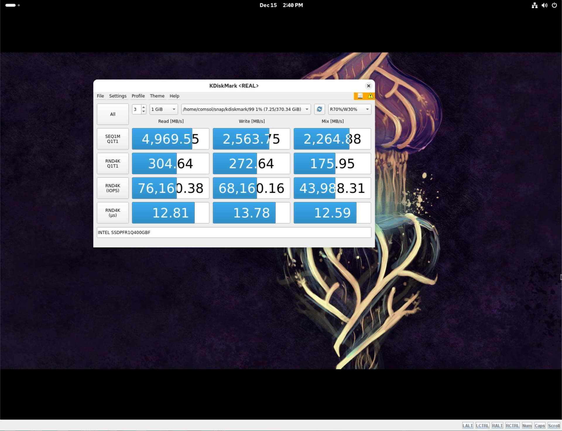

These are my scores running on just one disk, no mdraid:
Perhaps mdraid isn’t the problem and Linux just doesn’t handle the IO the same as Windows and gives different scores. I’ll install Windows next to see what I get.

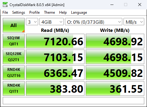

c) CDM with p5801x as main os drive on my threadripper build
1ge6t1vfyayd1
d) empty drive on ntfs
p5801x ntfs solo slot 1

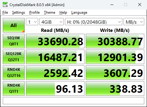

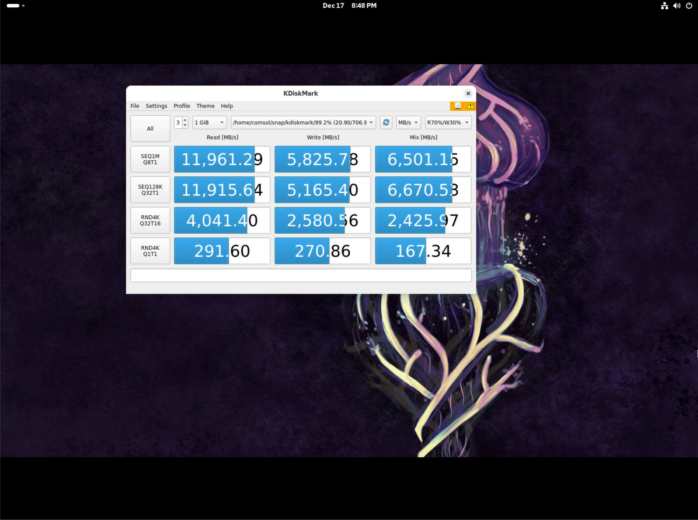

f) for comparison, 4x t700s via storage spaces
CrystalDiskMark_20241216112103

On ext4 i average 550, 16gb rand4k q1t1 benches above

I got VROC raid0 working via the MCIO ports, but the results were mildly disappointing, they are slower than mdraid’s results on linux:
I also Installed Windows and ran the benckmark but the results are really bad, like NAND bad. I’m pretty sure the issue is that Windows can’t schedule threads properly so the CPU clock speeds never go high enough to produce a good random numbers; this corroborates what @LiKenun was saying about the CPU being the bottleneck for random performance even more.
just for sanity, Which PCI slot do you have them/it in, on most boards you are going to have to put it in the first or main slot where you normally put a GPU, the closer you get to the edge of the board / further away from the CPU the slower they are, and significantly so, unless it is a premium board with redrivers on every slot - when I was first testing mine on a standard ASUS prime board moving even one slot dropped the speed from 380 to 300 on rand
edit: just saw which board you had doubt it’s that, probably worth the checking different slot speeds though
