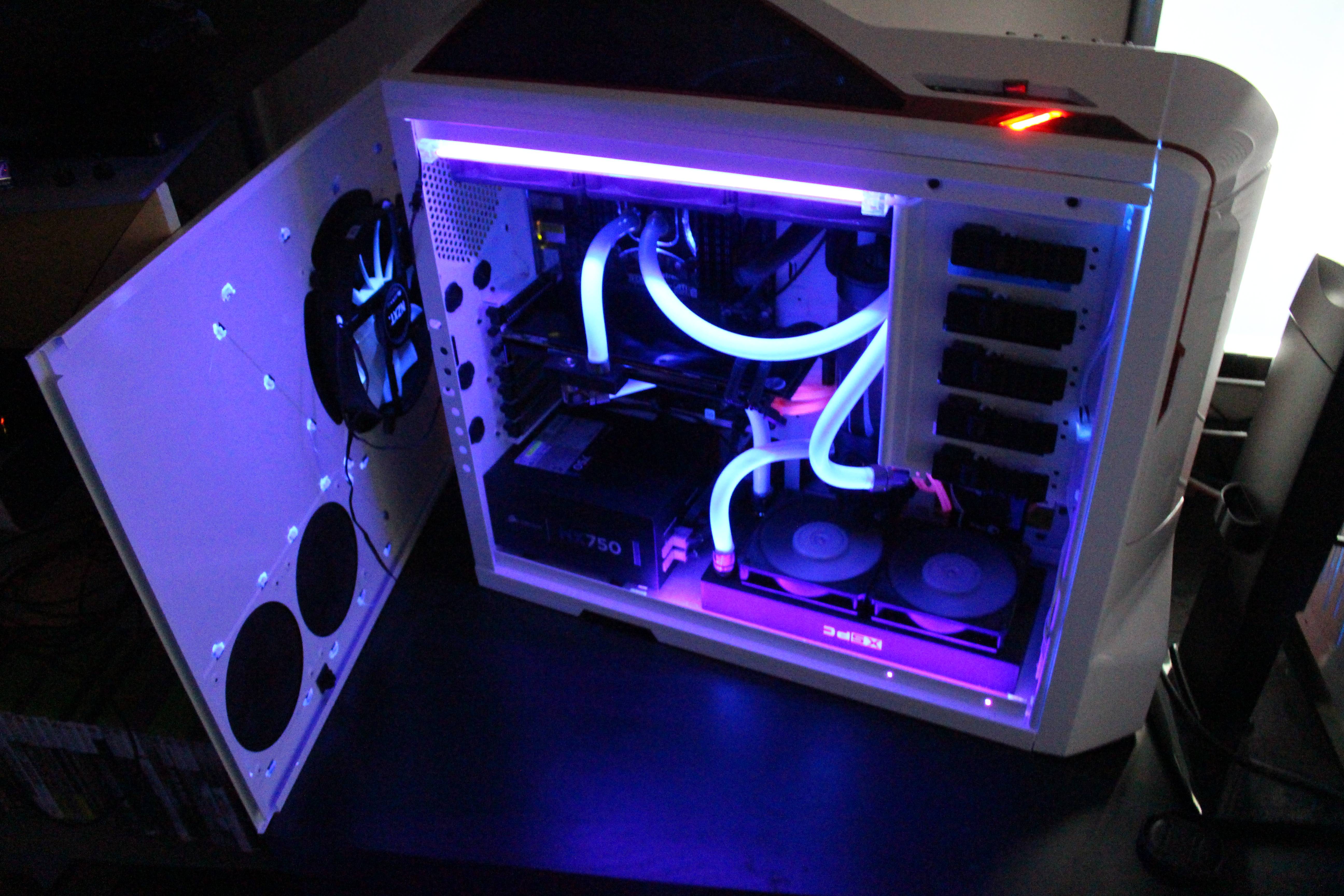

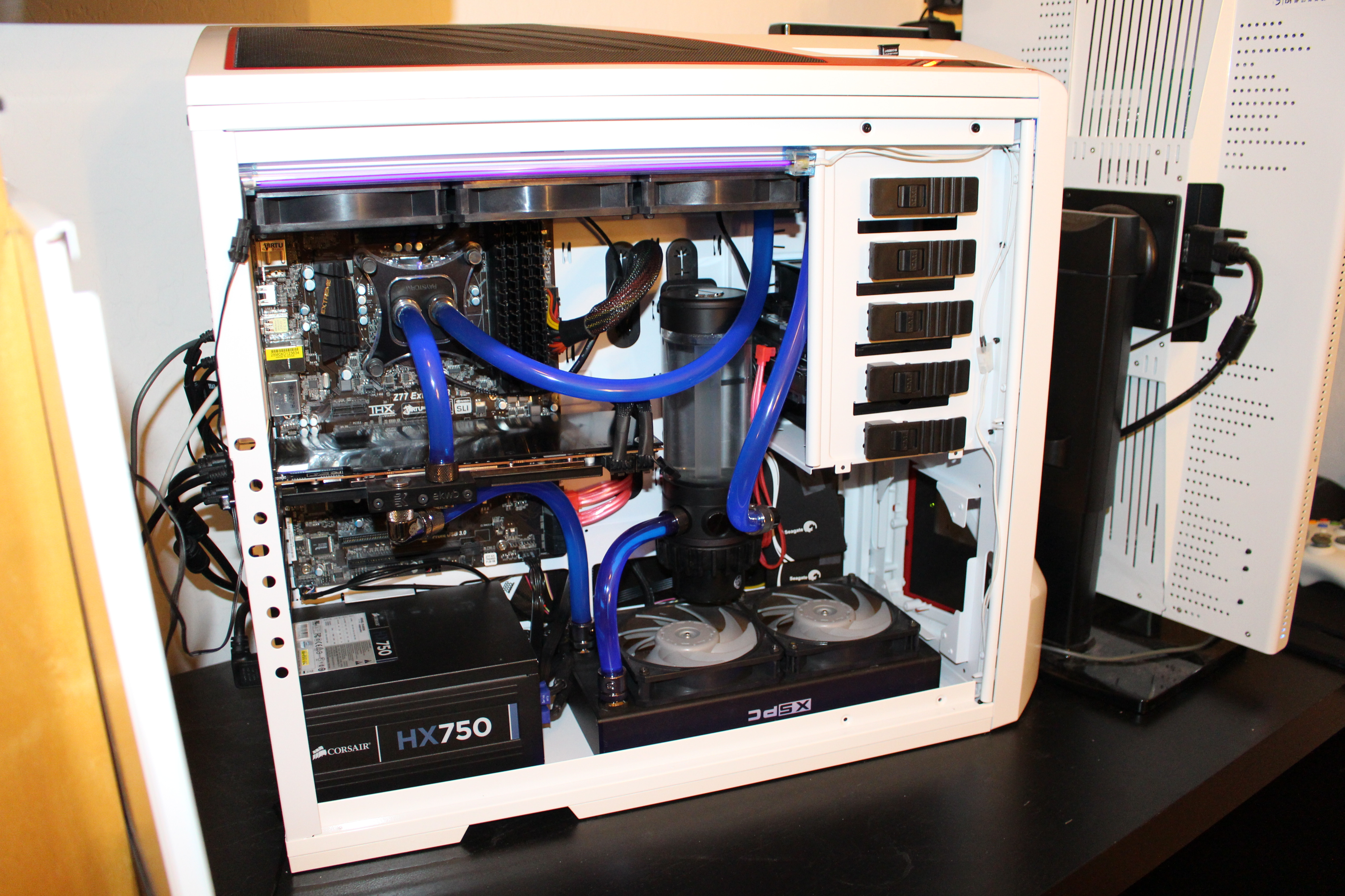

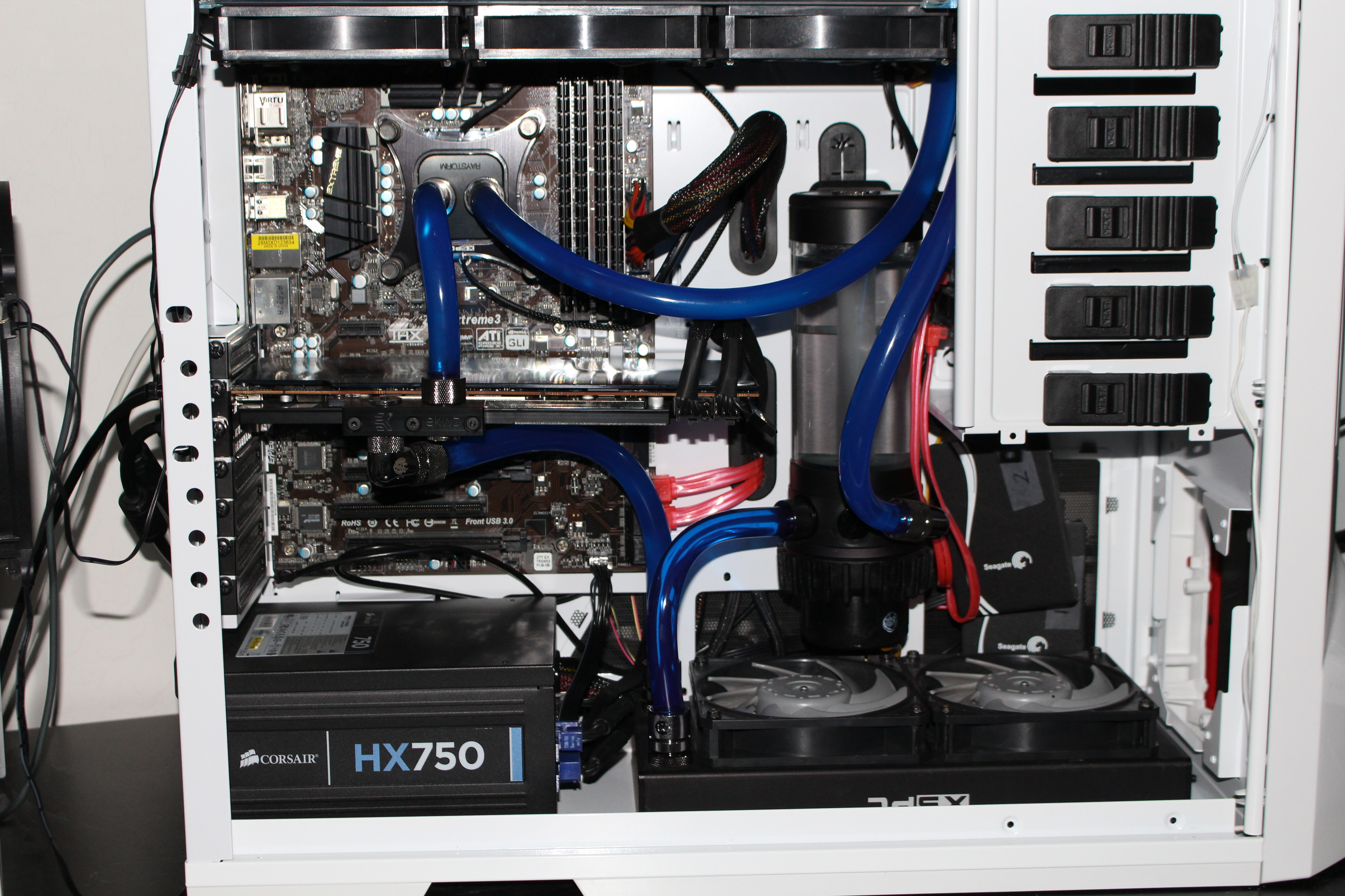

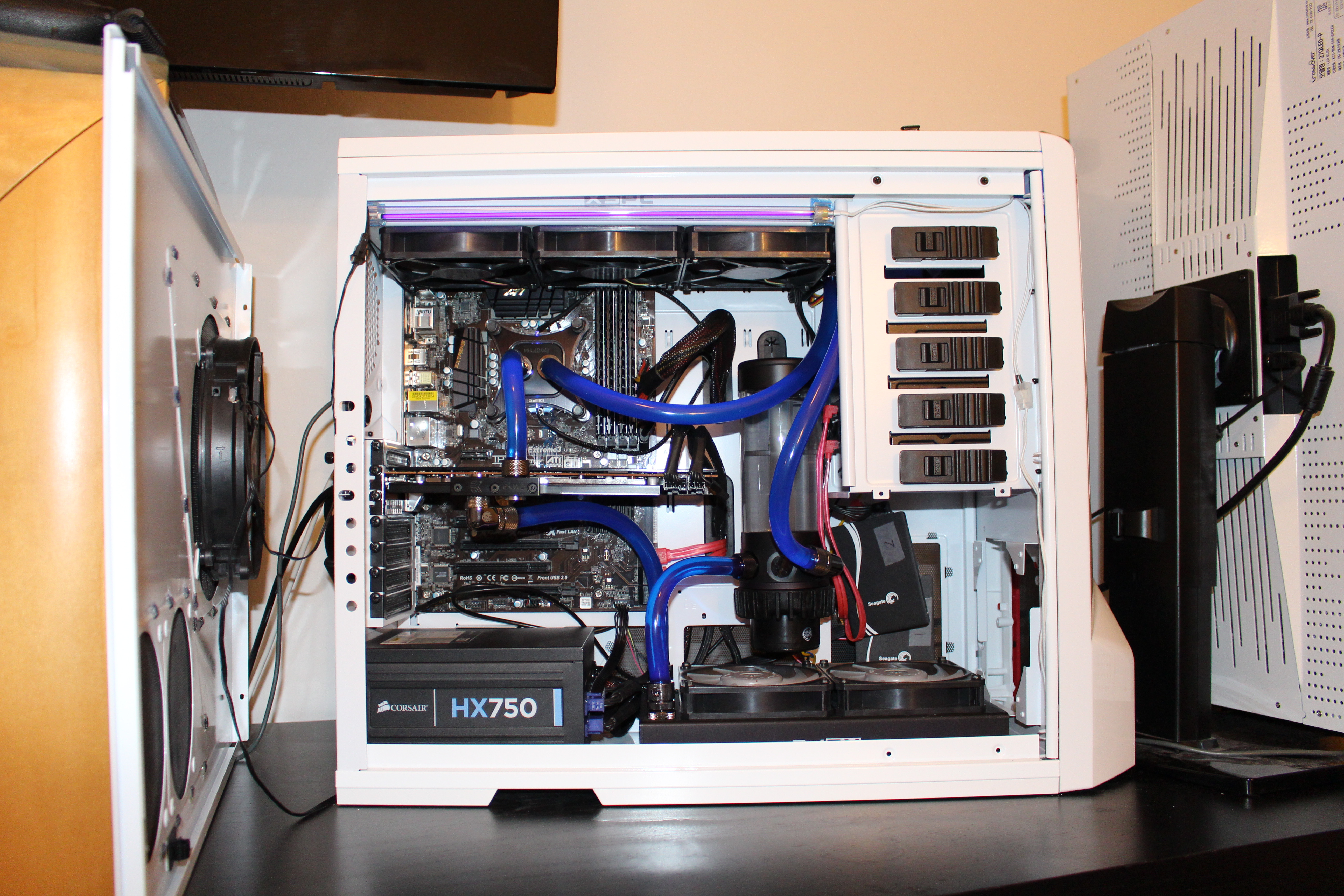

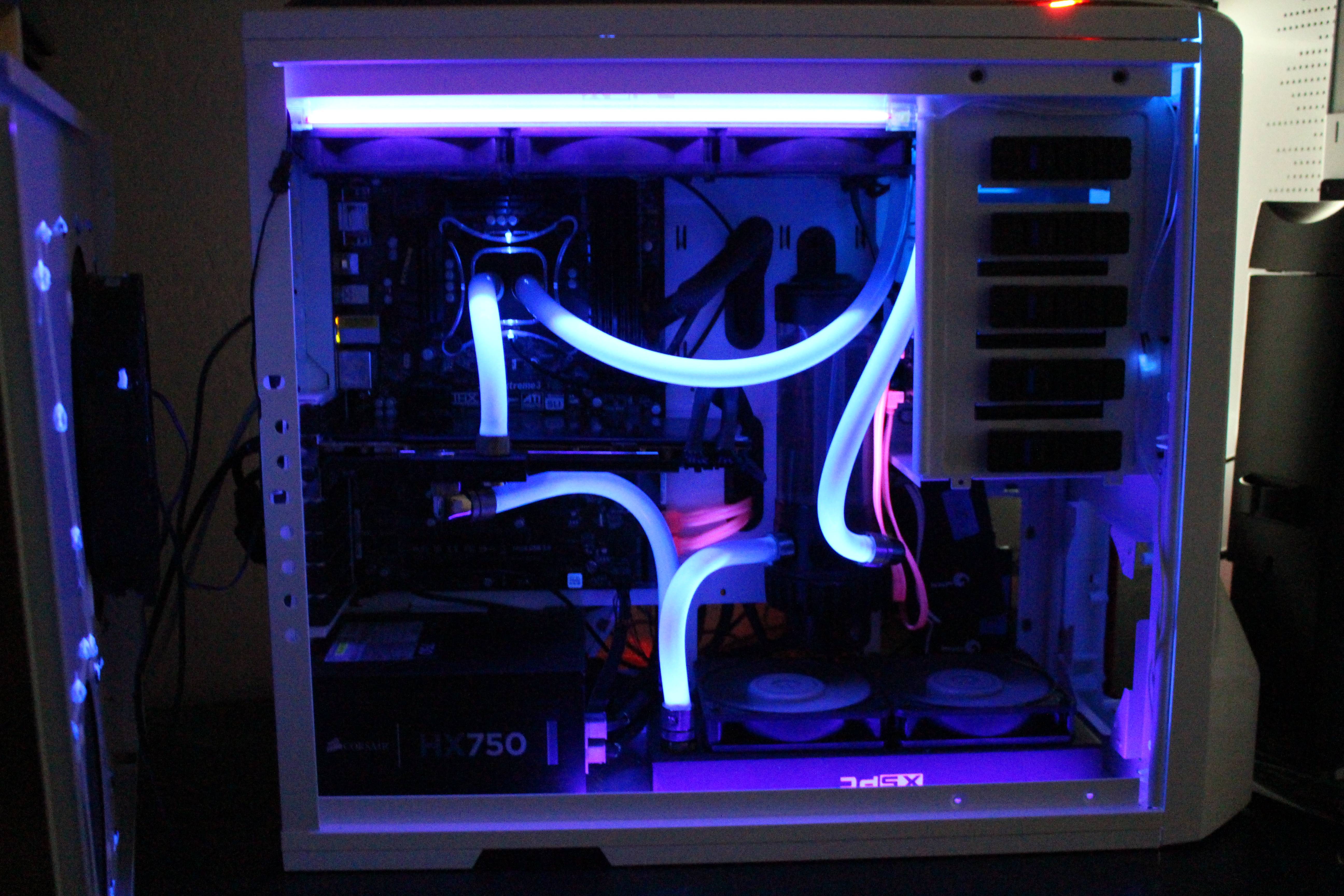

I was in the middle of tinkering with my loop anyways so I thought I would take a few photos for you. I have the original NZXT phantom so its not exactly the same as the 630 but its pretty close and maybe can give you a good idea of layout. I have an XSPC 360 in the top and a 240 in the bottom, then the 170ml pump/res from their kit. Please excuse the messy cables and SSD's awkwardly hanging in the background..
Full gallery: http://imgur.com/a/ggTxc
(Click for larger)
Glamour shots :D
cool thanks nice rig and gaming area you got there.
as far as the reservoir you have are there mount that you just drive in to the back and it holds it up like that?
the reservoir comes with mounting screws and you just drill the spots in the case where you want it. I did that in my old case. With this one though, because of where the cable grommets are I ended up just using 3 zip ties through the cable management holes. Works just fine and very secure
