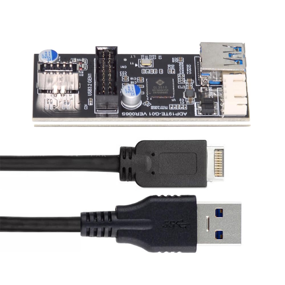

The BD795i SE lacks USB-C header. But I found this little piece which works great:
