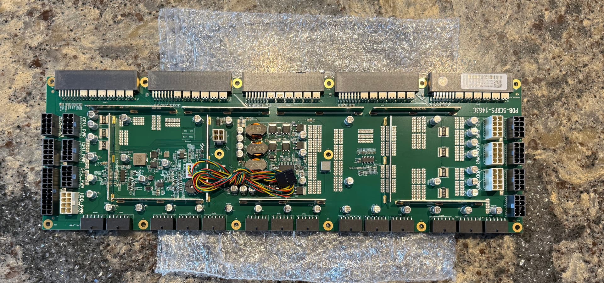

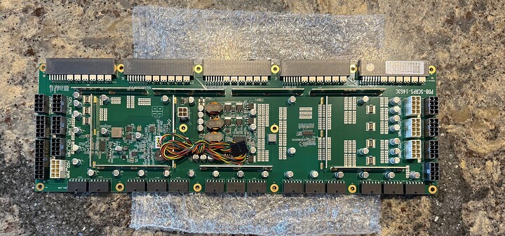

I might have bit off more than I can chew with this one. As the Blackwellening (thats a word, right?) of my GPU rig continues, I found myself needing an absurd number of 12vhpwr and the 4 to 1 octopus cables crawling all over my chassis are getting unwieldy. So I bought one of these things and a couple cheap great wall CRPS power supplies.
my new power distribution board
I now need help finding some compatible cables though and am looking for ideas. I was going to grab a multimeter and head down into the bowels of my mad science lab to try and figure out if any of the seasonic cables could be trusted to do the job, but figured it was worth posting on the forums first.
Anybody figured out how to wire one of these things up in a lab? Gotchas? Tips and tricks?

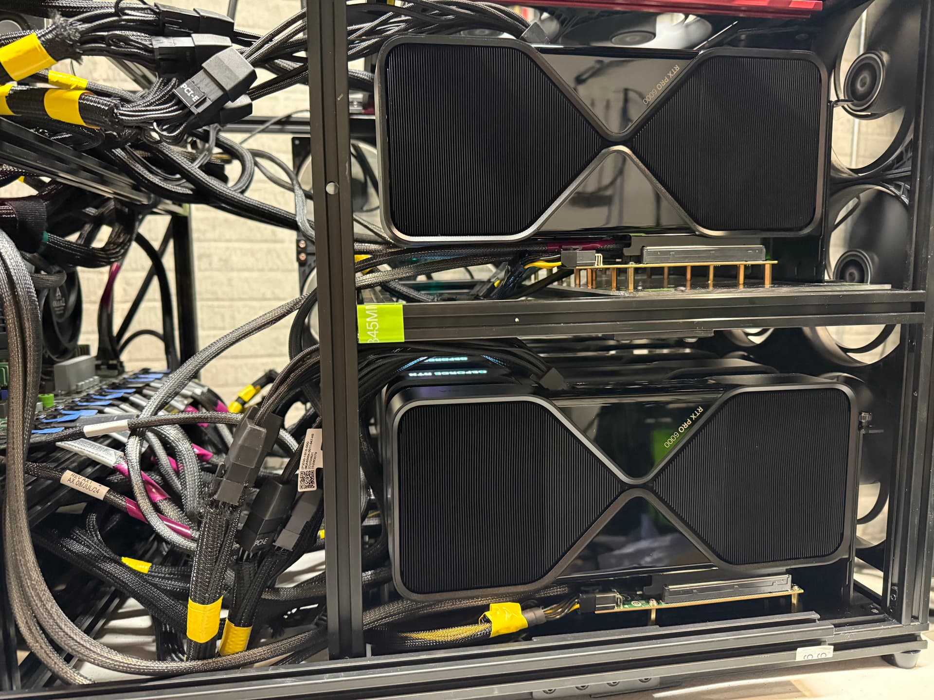

Edit: This is what I am hoping to rewire. Right now its 5x 1600w seasonic platinums.

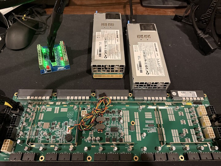

In case anyone else is ever lucky enough to come across one of these bad boys, I did the pin testing extensively before hooking it up to anything and determined it takes standard Corsair type 4 cables. Even if other cables like evga or seasonic fit in the hole, the pin out is wrong. But so far this thing is a dream solution to my GPU rig power problems using 5x1600w atx, while these great wall 1200w CRPS things are 23$ on ebay and plentiful.
