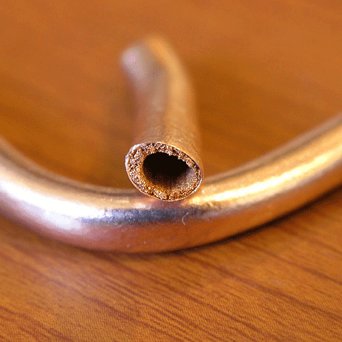

  2. Modding the CM Hyper 212 Evo, The 212 evo is perfect for me, though it doesnt fit in my case. Im thinking I can somehow shave the copper heat pipe top tips 2-3mm so it can fit. I don't think shaving the tops of the copper heat pipes would impact performance. If you dont know what im talking about in inspite shaving the top tips of the copper heat pipes here are some Photoshops (yes they are from google).

Potentially if you just need a very tiny amount. That said, I wouldn't advise it for fear of breaching the tops of the heatpipes. I cannot imagine they are very thick.
Is it because the 212 evo has vapor chambers in the heat pipes? My friend warned me saying if you shave the tips than you should watch out for the vapor chambers being exposed dramatically decreasing performance. I dont know, this is only one man, and he said orange and white is a hairy color so idk.
Heatpipes of all kinds are hollow and contain fluid/vapor, yes. Shaving them down could decrease their effectiveness to say the least.

As others have stated, the only concern is when you shave off too much and breach the hollowness inside of the heatpipe.
The fluids and vapors are what help move the heat from the base to the top of the heatsink.
Do you (or anyone) know how deep I would have to shave to breach it?
My A10 uses a T2 cooler. I also have the stock cooler on an 8320e, allot depends if you plan on OC'ing and how much.
Heatpipes work by boiling a liquid and condensing the vapor back to a liquid with a wick inside to help things out.
You could cut the side of the case and put a plastic air scoop or any mod you like. Heck even drill holes for the pipes. You can try to shave the pipes but once you hear a hissing sound its over for that pipe. Whatever you modify be VERY carefull of metal filings on the motherboard. Electrical shorts are bad.:)

I haven't tried grinding down heatpipes before, so no clue on how much excess copper there is on the end.
I wouldn't do that if I were you. The wall thickness of heatpipes isn't all that much hence the tip of the heatpipe can easily be breached..
People have ruined direct touch coolers just by lapping them flat. That's not taking even close to a millimeter of surface away from them..
Of course those flattened heatpipes are slightly more vulnerable than round ones but still.
