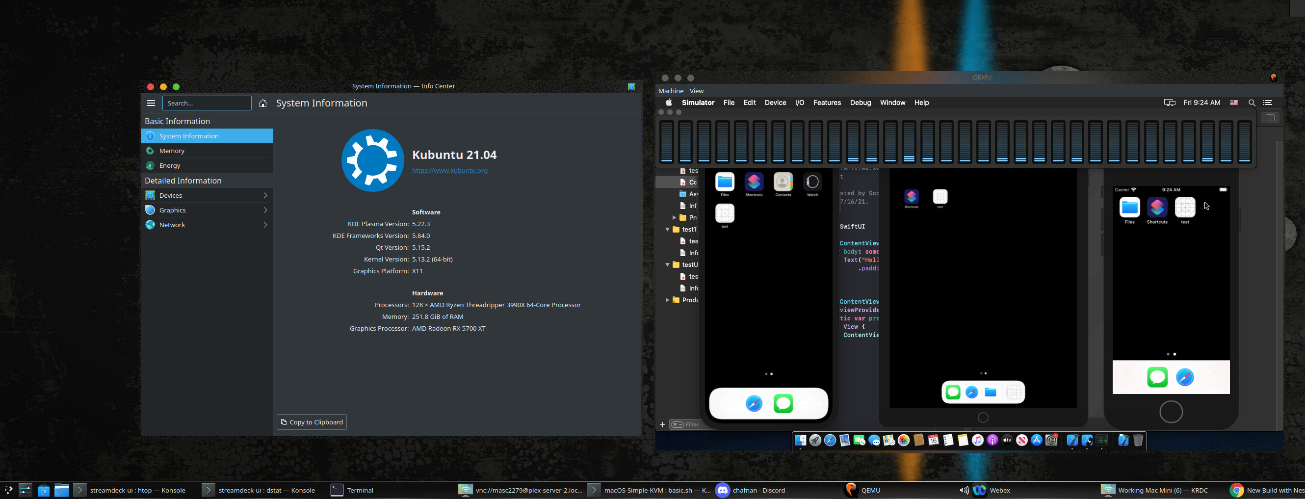

Had a few mins between meetings … here you go, not an issue at all 3 devices without issues.
also with the following
Having virtualization working inside a VM is possible only with the passthrough of the CPU, and not possible to emulate with an emulated CPU.
I am not passing the CPU directly this is normal emulation and not even passing a GPU in since the threadripper just chews threw anything in mac os.
Here is the steps to setup that i used …
absolutely no issues or special config to make it work it works out of box for AMD Threadripper.

Correct just using the normal setup of simpleKVM no pass thru of any kind and it all works … And for me its extremely responsive. But thats with a caveat …
- Threadripper 3990x whcih i can throw a ton of cores and threads at it and to me it runs just like native. But as you can see i thru 64cores at it from the picture grated it could not fit them all on the Activity Monitor LOL.
- Highpoint 7540 NVMe 8xFirecudat 2TB drives raid card set in RAID0 which is crazy fast ! so there is never a wait for the VM to fetch things.
- And a but load of ram.
So let me know if you want me to test Android Simulation in MacOS VM.
