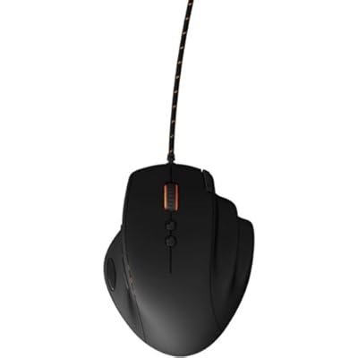

I have a mouse with heavy wear on it and it’s really hard to find a replacement for it. Does anyone have any tips for fixing/soldering a mouse cable? Should I use a soldering pen over a soldering iron? How much lead should I have in my solder. Should I use the same cable? Should I solder on a micro usb plug so I never have to solder on another cable again?
Take it apart, have a look at how it is connected, if it is wires through holes then it is an easy fix just desolder and either strip the current wire back a bit and reattach or use a new wire of your choice. I imagine the strain relief will be the most annoying part of this, they usually look molded on.

It is a func MS-3 rev 2. The mouse is really comfortable. And the closest I can get to it is either a Mionix which has no sniper button and does not have low enough dpi settings. Or the Corsair K65 with a sniper button. The Logitech G502 seems nice but I like a place to rest my ring and pinky finger. But does not appear to be as comfortable as the ms-3. And a new or used ms-3 would cost around 300$ to 400$.

Those are some crazy prices. Well then either you cut the cable where the problem is and don’t open it. Or you open the mouse and check out how it’s connected. Make sure to make pictures if you open it. It seems like I cant find a disassembly of it.
I am using this exact same mouse right now.
