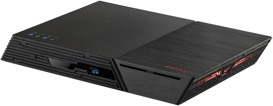

If you can live with not having HDDs, this is the most power-efficient alternative with ECC (yeah, Flashstor is back with ECC RAM, booyah!):

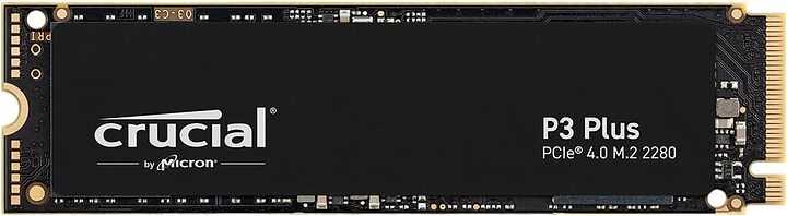

Combine with 4 of these to start with for a total of ~$2,200:
All flash is getting there, still not quite as cheap as HDDs, but not completely unviable anymore, either. :slight_smile:
Do you happen to know if this has sata power plugs inside it at all? I had a random thought about using one of these with m.2 to u.2 converters to run a bunch of 1.5TB Optane drives off ebay for a NAS. lol
Though Im guessing 20w per drive is probably going to reach a power limit pretty soon and wouldnt be able to populate all 12 slots.
I don’t think you won’t get anywhere near enough airflow in there to deal with U.2 drives. And if you have to remove the shroud, you may as well use external PSU with all the SATA power you need.
