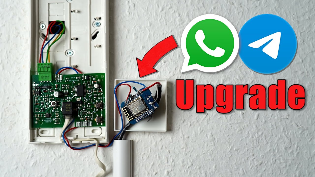

On the kick-ass part of the spectrum you might be looking at something like a pair of Ankke NC400 or NC800, a small pc with a Google Coral accelerator running TrueNAS for storage + Home Assistant in a VM using Frigate. You could repurpose the doorbell physical button with an esp32 to send notifications to phone using home assistant home app.

GreatScott! just did a video with some info about a doorbell and notifications. As per above, you can add different types of sensors, such as motion detection, to an ESP32 and have a separate camera. I know there are options for object detection/differentiation, including ESP32’s with cameras, but if you don’t specifically need that aspect then to me it seems much simpler to set up a separate IR sensor and work through any physical false positives than trying to work out false positives in software. Then again I’m a mechanic, not a programmer, so my perspective is skewed.
