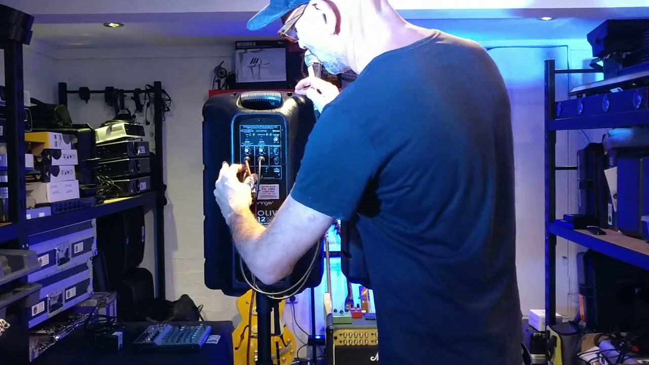

You can go direct to the speakers with both mic and phone, but line out level /bluetooth from the phone will suck (volume will be really low), bad, and you wil think your speakers suck, where in reality it’s just your phone out that isn’t giving out enough volts …
Quoting myself, this shows how to go at it without the mixer (line out from the phone will suck in terms of levels/output strength)
