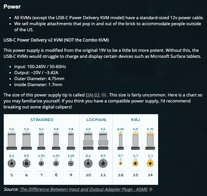

I’m looking at purchasing this same KVM. Based on my research on the forums, it’s sold with a 70W power supply (screenshot from [0]).
Screenshot 2026-01-06 at 08.31.45
If you’d like to use a more powerful PS, there’s been some recommendations of some HP bricks, but most I’ve found don’t have the specific barrel plug needed to plug into the KVM.
The specific barrel plug is the EIAJ-03 (4.75mm OD, 1.7mm ID), screenshot from [1].
My question for @wendell : If I buy a 150W or higher PS, is there a specific current limiter in the KVM to prevent exceeding 135W draw?
Last, I’ll note that I’ve found the barrel plugs in stock at Mouser [2], just make sure the power supply is greater than 120W, and delivers 19.5V DC. When soldering, ensure the polarity matches what the KVM is expecting.

oops we missed this somehow. it’s easy to order power bricks from us but there’s been some evolution of the USBC pd kvms over time as we keep going up in wattage and changing the barrel size as a result
so pics help
Hi I can get this information updated in the FAQ and provide some context here. The current v3 USBC KVM has a 135w power supply, which it does comes with.
The discontinued v2 USBC KVM is compatible up to 120Hz, however, they were only packaged with a 70w power supply.
Anyone who would like to purchase a power supply can submit a support ticket for purchasing info!

ah so the kvm is pretty forgiving on voltage too from 19 to 21 volts, too. Microsoft surface devices like to have about 20-21 volts, it seems, which we discovered in the Trial By Fire with Microsoft devices.
So the power brick can actually make a difference (and this is true of any usbc kvm or dock) in a very very narrow windows, surprisingly. I like the newer model usbc pd kvms a lot more than the old ones. Also it seems like the blink of an eye devices went from ~65w to ~250w.
