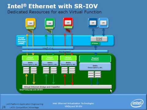

I’ve never really played with SR-IOV, since I don’t have any hardware that supports it yet.
Virtual anything. Gaming will always be best on native, but I’m always interested in collecting data on the limits.
For anyone in the future that might read this thread and wonder what SR-IOV is here’s a vid kinda’ to help explain.
Of course this vid is talking about a NIC, but the premise of SR-IOV will work with just about anything that uses the PCIe bus providing the necessary support and driver is there to take the load off the hypervisor at least in theory.
