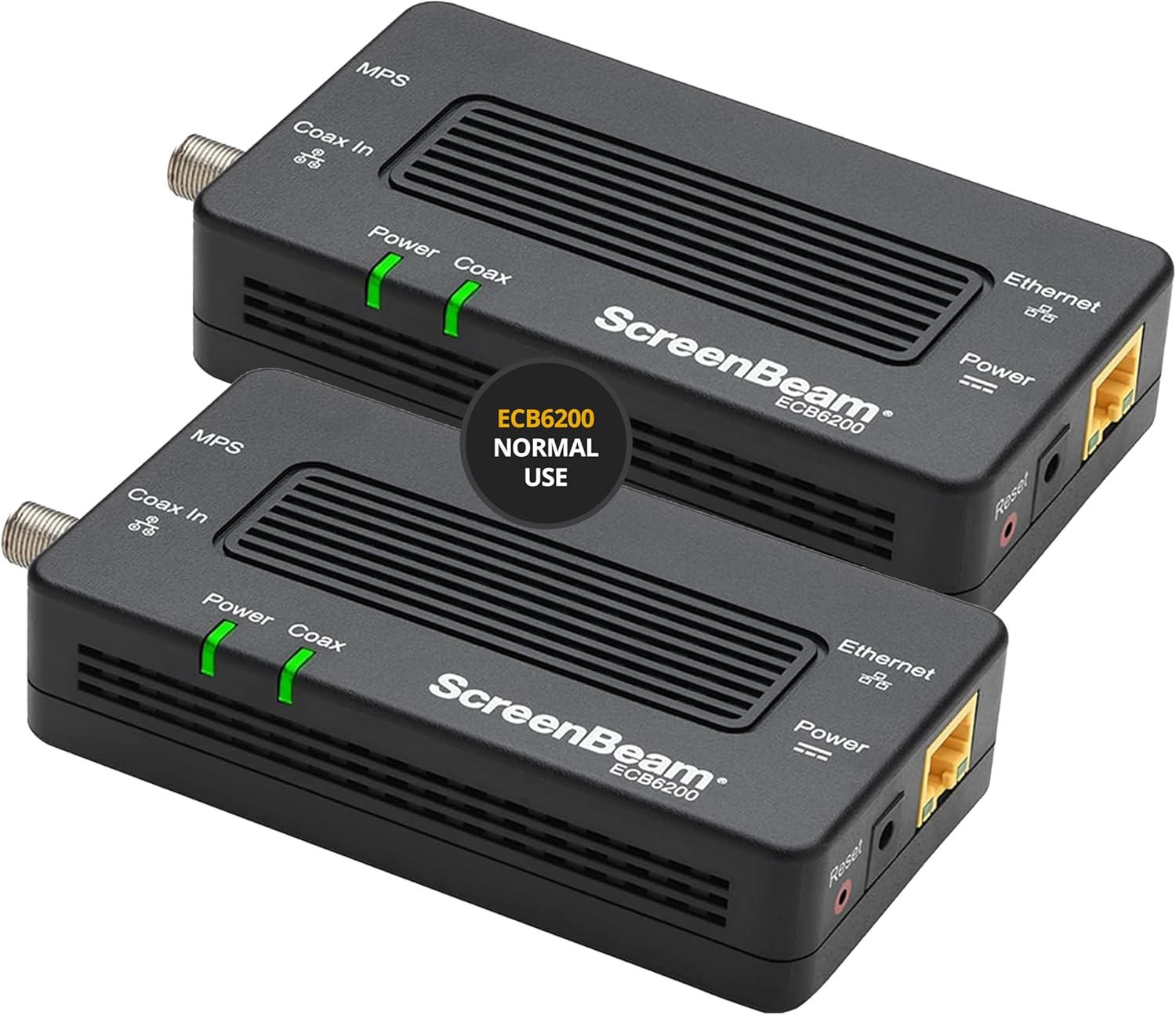

I suggest MOCA 2.0, which transmits ethernet over the coax cable your house probably already has wired. It’s much better than powerline. Then plug in a second wifi AP (or your second Eero node) at the other end.
And just a further point of optimization, if you’re a cable cutter you can save a ton on DECA adapters, which are essentially MOCA for DirectTV users, so it uses the same frequencies as cableTV to transmit ethernet. But don’t get it if you pay for cable TV, as it won’t work.

What is “bonded MoCA 2.0”?
**Requires that your router support bonded MoCA 2.0.
I set it up at my parents’ house. Real-world latency and consistency is like ethernet, as it’s wired. So it’s useful for stuff like online gaming and streaming video without stuttering. Bandwidth is around 600Mbps.
Bonded means it combines two frequency channels to double the theoretical bandwidth to 1Gbps.
Cool, that’s not bad.
I know what it means abstractly, but is “bonded MoCA 2.0” some sort of proprietary protocol or are they just saying that it supports bonding?
I’m confused because the adapter just has a single ethernet and an in/out for the coax. Do they mean for you to bond the 2 adapters via LACP or something?

These devices can be used two ways. If your router has a COAX port for HPNA MoCA 2.0 rated you connect that to your CATV cable and use them for an Ethernet connection for devices at the other end. Or use one to connect to your router at an Ethernet LAN port or use the WAN port if available and connect to your CATV COAX. Then use the other off the COAX at the other end for Ethernet to a device such as a PC, Router, Switch, etc. Or if you have a MoCA 2.0 enabled network range extender like the Actiontec ECB6200 Bonded MoCA 2.0 Network Adapter, it will connect direct off the COAX cable. So yes if you use two as you suggest you will get full speed bridging. MoCA 2.0 offers 400 Mb/sec to 800 Mb/sec actual depending on whether they use channel bonding. I got 640 Mb/sec actual and stable on mine over the CATV COAX. My CATV setup in my house is in the home run configuration. Make sure all your splitters in your home are MoCA 2.0 rated for 5-1675 MHz frequency for best results and include an MPOE filter at the CATV providers input to keep your network signal from exiting your home.
Yeah, I believe they’re talking about Verizon FIOS routers there, which use MOCA 2.0 to pass connectivity throughout your house to their set top boxes, which use IP to watch TV.
This is important assuming the coax is connected to the line coming into the house. Don’t want your LAN traffic spilling out into the neighborhood.
