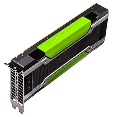

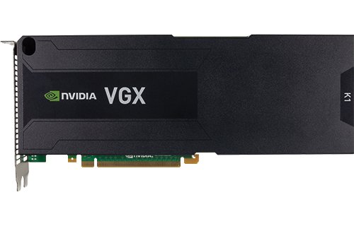

k80 or k1

let me know about this build and add one K40 with this https://pcpartpicker.com/user/tamal/saved/
