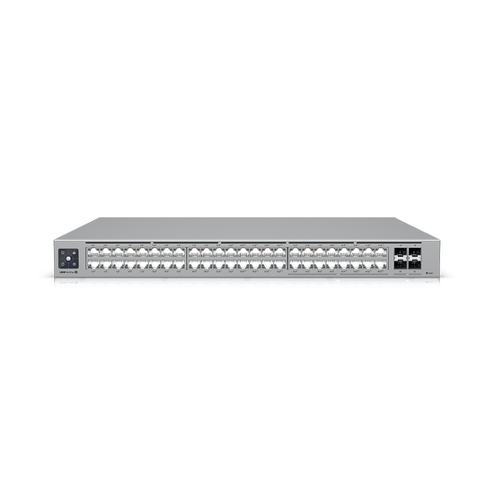

In my ever evolving bit of tinkering I will be rebuilding my Unraid server.
I have gone a bit crazy (for my modest little homelab) and plan to cram a bunch of SSDs in it (at least 8x 2tb Micron 1100s). I’ve had 10g networking for a while and it is well deployed throughout the house.
That said, because I have an addiction, I got the Ubiquiti Beast on day one. The 25g ports call to me. The beg me to pair them with those SSDs and make file transfers go burrrrrr!
For a hobbist/tinker-er, is there any reason to try to get those ports in use. Or am I not going to get any practical benefit from them.
I’m open to totally manufacturing a reason to justify the build out.

Well, besides the UDM Beast, I have:
And
In the rack.
