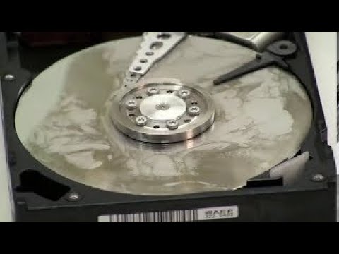

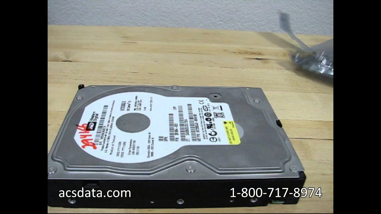

Do NOT I repeat NOT put the drive in the freezer!!! Basic physics says that you will ruin the platters and everything else proabably, because for ex. condensated water that will build up.
If you want some proof watch this:
