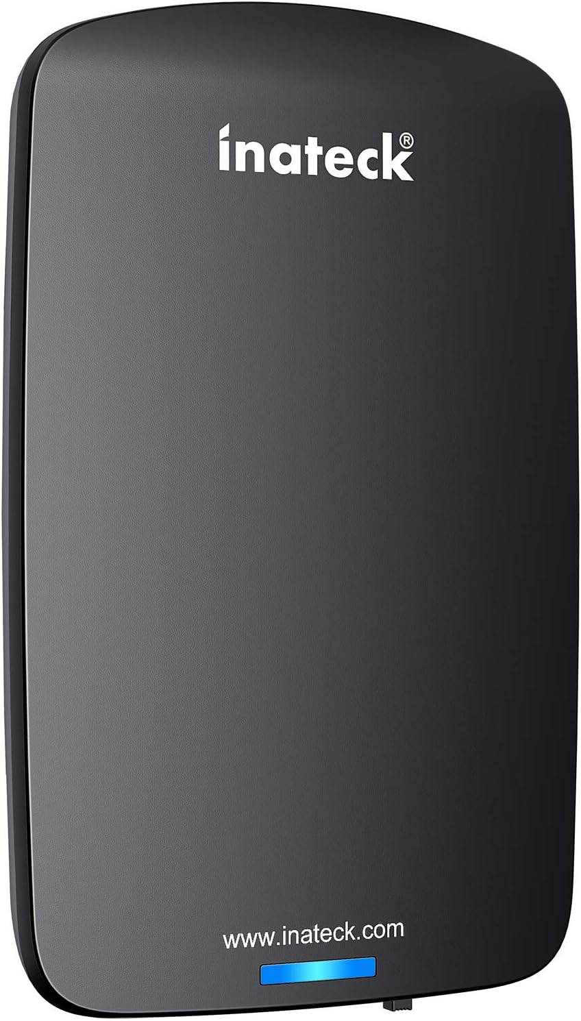

Pretty sure that solution usually doesn't work 100% and if you're trying to clean the system a fresh install is the best way, with the SSD you still have all the data on the hard drive, so you can just buy a 2.5" enclosure and turn it into a portable hard drive
This one's USB 3.0 at $13
