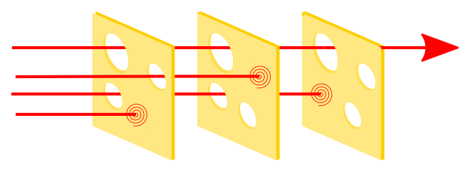

I think it’s useful to think of these things with the swiss cheese model. ECC adds another layer of swiss cheese for potential issues to be caught by. Whether it’s important for your use case and budget is a personal decision, but one cannot deny that it is a method of catching potential issues.
