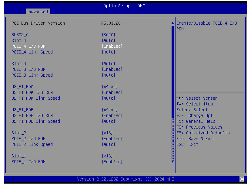

You should also go into the firmware settings and set the relevant ports to Auto or x4x4. By default, NVMe/SATA combo ports on Gigabyte SP5 motherboards are set to SATA only.

It’s not really a bifurcation thing. I haven’t tested on mine, but I’d be very surprised if these boards can’t do auto bifurcation. Rather, Gigabyte’s defaults had these ports running under SATA mode. (link groups P0 and G3 on an SP5 IOD can operate under SATA mode). Changing the mode to Auto or x4x4 makes the ports run PCIe.

Thank you everyone for the pointer. You are right about the MCIO ports default setting (SATA interface). After changing the value to x4 x4, both Micron 7450 Pro NVMe drives are detected
