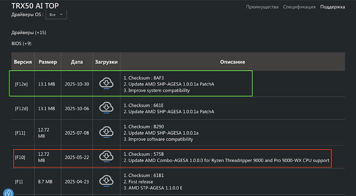

Hello,
We’ve encountered the same issue when running LLMs using inference frameworks like vLLM or Sglang in a multi GPU configuration using two NVIDIA RTX PRO 6000 Blackwell Max-Q GPUs. After testing LLMs, when I attempt to shut down the machine, either via sudo shutdown now or the desktop UI Power off, it occasionally reboots instead of powering off. After it reboots once, I am usually able to shut it down normally. The issue is non-deterministic. It sometimes shuts down correctly, but other times it triggers a restart. We tested on the four machines with below configuration. The same issue on all machines. Please help to fix it.
  • Motherboard: Gibabyte TRX50 AI TOP
  • CPU: AMD Ryzen Threadripper 9960X 24-Cores
  • GPU: 2xNVIDIA RTX PRO 6000 Blackwell Max-Q
  • PSU: FSP2500-57APB
  • OS: Ubuntu 24.04.3 LTS
  • Kernel: 6.14.0-37-generic

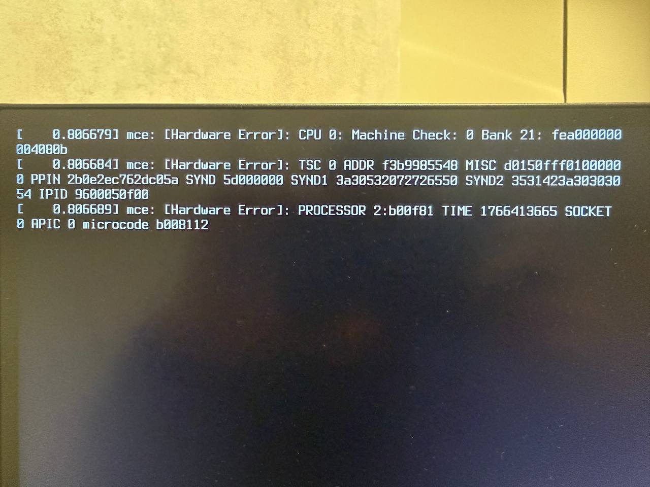

Here is what appears after an unsuccessful shutdown:
Full Error log:

Dec 23 11:39:34 admin2-TRX50-AI-TOP-ProArt-S0EB kernel: mce: [Hardware Error]: Machine check events logged
Dec 23 11:39:34 admin2-TRX50-AI-TOP-ProArt-S0EB kernel: mce: [Hardware Error]: CPU 0: Machine Check: 0 Bank 21: fea000000004080b
Dec 23 11:39:34 admin2-TRX50-AI-TOP-ProArt-S0EB kernel: mce: [Hardware Error]: TSC 0 ADDR f6f2ada8d1 MISC d0150fff01000000 PPIN 2b0e2ec762dc05a SYND 5d000000 SYND1 3a30532072726550 SYND2 3531423a30303054 IPID 9600050f00
Dec 23 11:39:34 admin2-TRX50-AI-TOP-ProArt-S0EB kernel: mce: [Hardware Error]: PROCESSOR 2:b00f81 TIME 1766471971 SOCKET 0 APIC 0 microcode b008112
Dec 23 11:39:34 admin2-TRX50-AI-TOP-ProArt-S0EB kernel: RAS: Correctable Errors collector initialized.

Dec 23 11:39:35 admin2-TRX50-AI-TOP-ProArt-S0EB kernel: MCE: In-kernel MCE decoding enabled.
Can you point a 140mm fan at the dimm area of the motherboard and retest/retry? anything in the output of lmsensors?
Hi @wendell, the RAM is 256GB (Kingston KSM56R46BD4PMI-64MDI). We are using the ASUS ProArt PA602 case with the two fans inside, and we have four identical machines. Could the issue be related to the BIOS version? We are currently running version F10.
the memory could be throttling properly but give it more airflow to see if that changes the situation. just pop the side off and manually place a fan so there’s more airflow over the dimms just to see what happens
Hi, I have the same issue. Also have TRX50 AI Top (bios F12d), a ThreadripperPro 9985WX and 2x RTX5090s, memory is G.Skill F5-6000R3036G16GE8-G5N. I run it as a server with Proxmox. It shuts down when it wants, sometimes at first time sometimes a have to insist many times after a couple of self reboots.
The issue was due to BIOS firmware. We updated it from the F10 to the f12e. Hope it helps.
