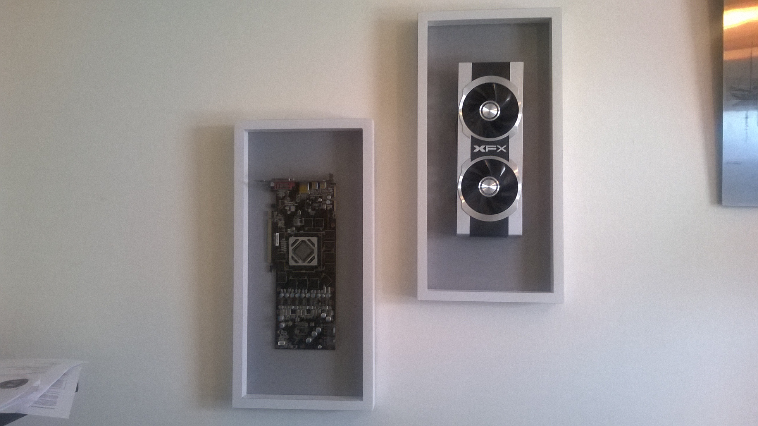

As for the MSI board I might mount it on the wall like I did with my XFX 7970 when it died.
Imgur
