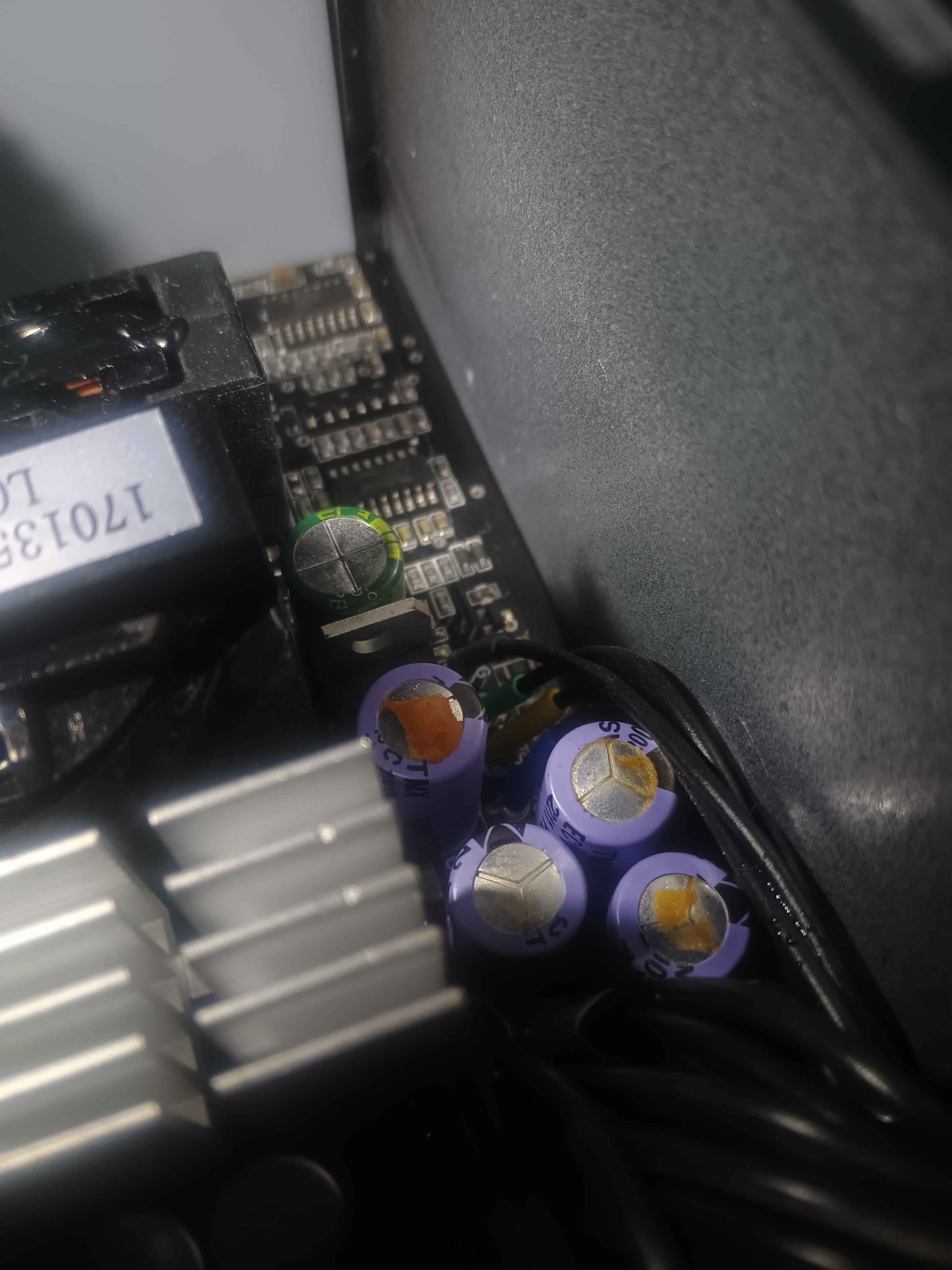

After all these years this is (i think) my first. Decided to pull one of my spare rigs out of storage to test it. First it powered on/off and refused to power on again. The RGB on the mobo was still lit, so i just suspected some mobo/bios issue and decided to do full cold-reboot. Turned PSU off and drained all the power until RGB on mobo turned off completelly.
After i flipped the PSU switch back on and turned the rest of the PC on i was awarded with nice stream of smoke from the PSU area. For about 0.5s i was amazed what i see then turned off the PSU via its switch and pulled the cable.
At first i suspect there may be a bug or spider or something, that got cooked inside it as i turned it on, but looks like it had few caps leaking and after i turned it on after a few months of being off, it decided it doesnt like me anymore :smiley:
I could probably order new caps and fix it, but not im not 100% sure leaking caps were the cause or if some weird short could cause caps to blow up like that, but i guess i could try :smiley:

if the caps blow up like that there is something that failed and overloaded them imho.

Yunxing doesn’t have a stellar reputation for quality capacitors though; It wouldn’t surprise me if they just killed themselves.

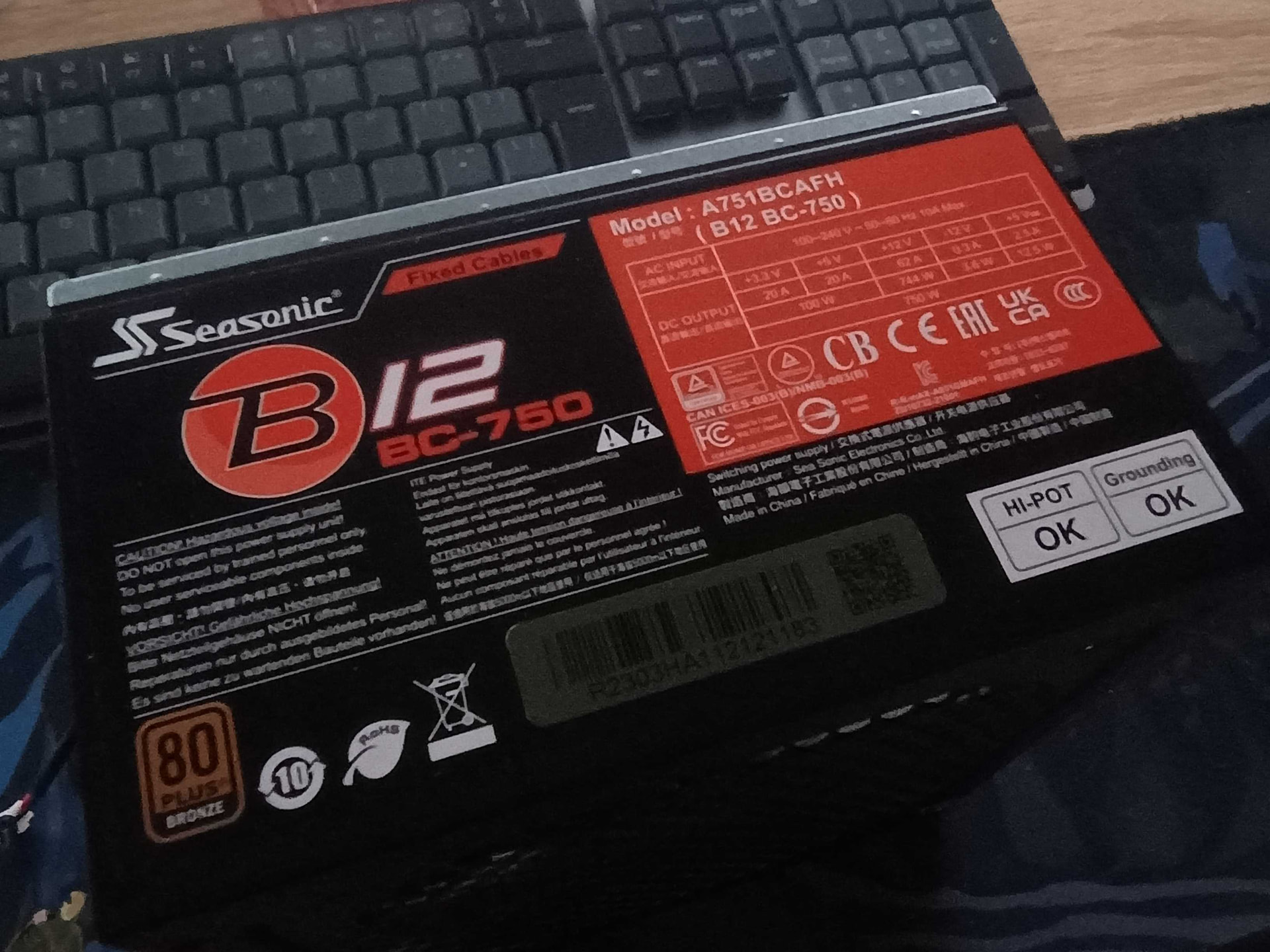

Seasonic BC12 series was launched in early 2021. Looking at your unit, I bet it’s still under the 5-year warranty. Losing your receipt is unfortunate though.

However there might be a deeper underlying reason why those caps failed.
It might be due to bad quality or age of course.
But there could also be a problem in the circuit like a bad transistor or whatnot.

Since its all 2200uF 16V caps that seem to go bad i suspect a bad batch

Ye i may try to replace them, then put big sticker on it “experiments only” and dont have it inside any serious rig and use it for stuff like fan testing or similar stuff

found these 2 caps, bit on a pricy side, but on the other side i dont want to buy some chapo ones that would blow up in a few years again :smiley:
https://mouser.com/ProductDetail/Nichicon/UKL1C222KHD?qs=sGAEpiMZZMsh%252B1woXyUXj%252BsOhbvm7UEcMVcDzsH%2FB%2Fo%3D
This one is rated up to 15k hours, but its not exact “blow up on top” type :smiley:
https://mouser.com/ProductDetail/Chemi-Con/APSG160ELL222MJ20S?qs=nxZbHzLpdvcUAIXRVD5aZg%3D%3D
edit: suggestions on different caps/parts welcomed :smiley:
