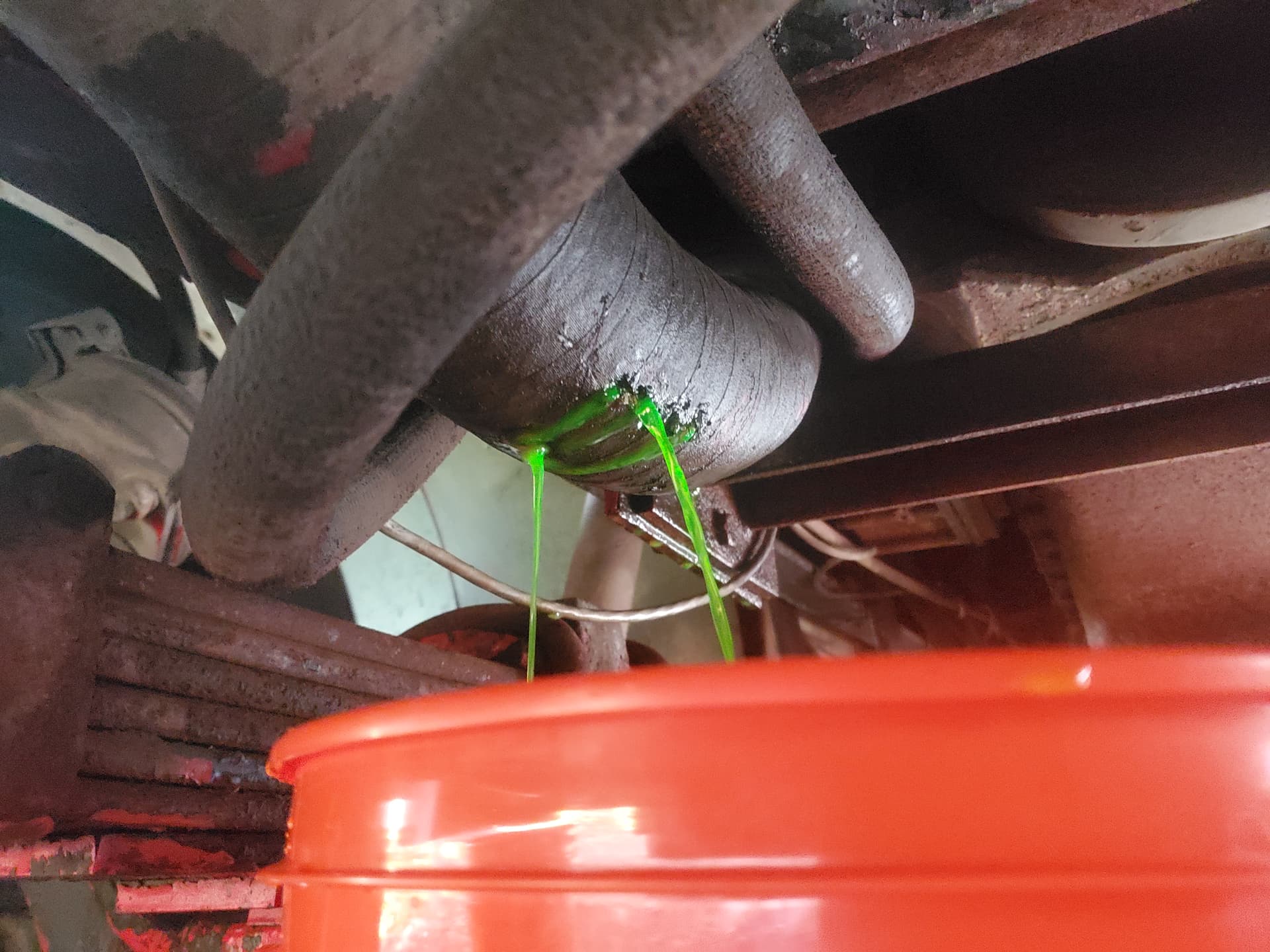

i haven’t been messing with tuning. i found a coolant leak in the intercooler (uses tank water to cool the engine), so i gotta try and isolate that first. and then fill the coolant again.
got the tank to pump out. freed the check valve too.

Valve rebuilt.
There was a stuck check valve that was likely causing the issues. Broke it free with a screwdriver. Cleaned up corrosion and scale.
Got the valve installed today, 95% done
Finished the valve, got water flowing!
but sprung a coolant leak at the fire muster, had to take it home early :frowning:
main lower coolant hose needs replacing. recovered 9 or 10 gallons of coolant.
