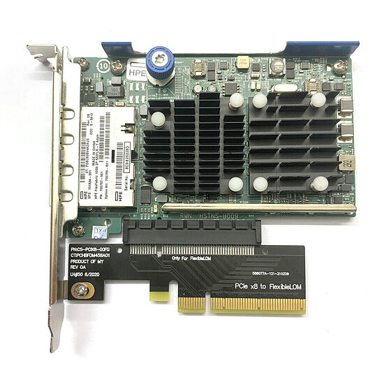

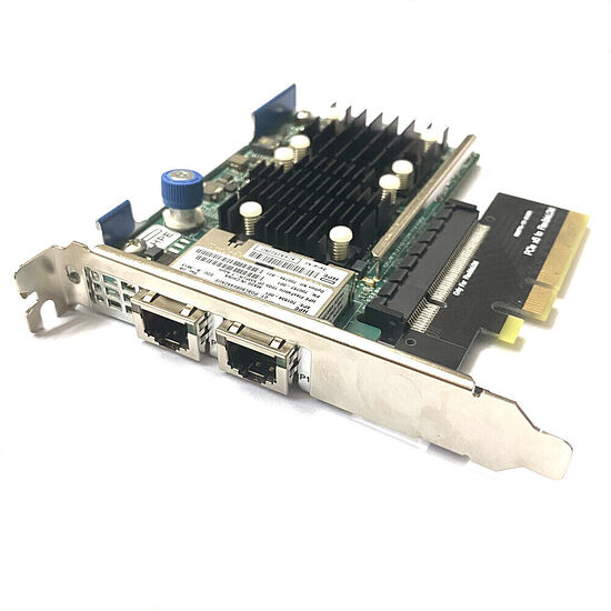

A while back I stumbled upon these FlexibleLOM (HP proprietary expansion port) to PCIe risers so you can run HP network cards like HP 544FLR in your pc.

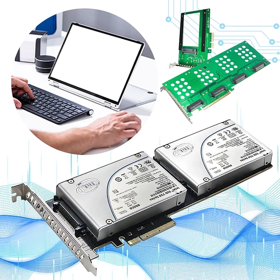

Did I forget to post about these U.2 to PCIe adapter? There’s 1/2/4 version of them. They look super simple so I assume they need bifurcation support on the motherboard, but it’s a nice way to get a U.2 port, or make your own cache card.

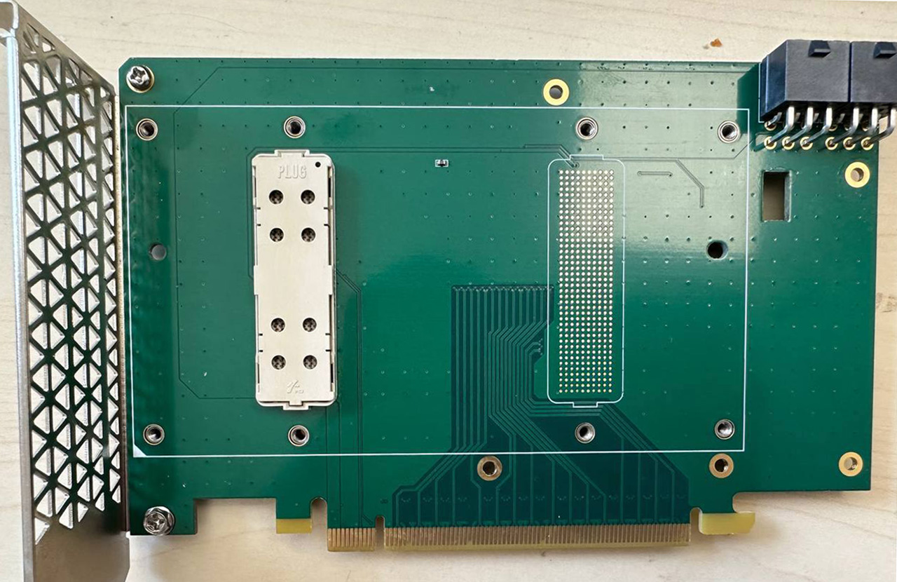

Ooooh… there’s this too. A SXM2 to PCIe adapter
But by some reason it seems like the Chinese are hiding those away on Taobao. (That’s like $10!!!?)
That is pretty cool. I recently acquired a nvidia v100 sxm2 module for an art project, but once that display has finished it might be good to put it back to use.
