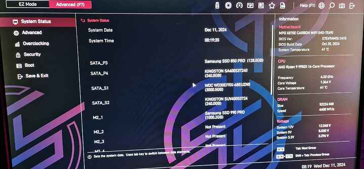

Every few days after a restart or shutdown, I’m greeted with a message that the hardware changed and I have to load the default values in BIOS. After entering UEFI, I see that the system sometimes sees 52224 MB RAM, sometimes 6144 MB RAM (wth?!). At this point, I can go on, log in to my OS which indeed reports that I have only 6GB or however much of RAM it detected, or i can clear CMOS with the button on the back of my MB, which makes it see the whole 96GB again, but at the default factory speed of 4800 MTs. So I then need to again set it up to 6400 MTs, enable IOMMU and SVM for the virtualization I plan to play with sometime soon and then restart back into my OS.
As for the BIOS settings, it’s updated to the latest version from a couple of days ago (didn’t help), and the only things I set up differently from factory settings are:
  • RAM speed (xmp profile 1),
  • PBO to AUTO (Thermal limit of 85 degrees C - MSI’s setting)
  • Game boost Enabled
  • IOMMU Enabled
  • SVM Enabled
I wanted to know what do you people think it’s going wrong? I tried reseating the RAM, going with integrated GPU, unplugged in and out all the cables… Nothing helped so far. I’ll put detailed system info below. Thanks in advance for the advice :slight_smile: .

Happened just now. Based on this case, we could maybe conclude that the B2 slot has an issue, but there was a case where it was reported that the Total RAM was 6GB, meaning both slots experience something.
I left it on default values now at 4800 CL 39 JEDEC setting, let’s see if it will happen again.
Bios fail
Memz bios photo
Memz bios photo after clearing CMOS

Hi all. After some months of the issue not reappearing, I thought it kinda fixed itself. Then by accident I saw this topic today on CachyOS forum. The symptoms are bizarrely similar, so I’m wondering if this could be the culprit?
Hello, Reboot here over from the CachyOS forum post you referred me in
From my research, i’ve encountered the following:
  • Your OS (in my case CachyOS, can be any Linux based distribution) tells UEFI to update its UEFI CRL (dbx). Our UEFI firmwares (thanks MSI i guess lol) then does not append the CRL properly, and I highly suspect it is writing dbx entries into unintended parts from firmware (resulting into corruption).
  • You tell your OS to suspend (sleep). Your distribution may tell Linux to enter the S2RAM state. Linux will then talk to UEFI, requesting a S2RAM state.
  • The firmware handles a corrupted instruction, which will in turn cause the symptoms we are facing: corrupt memory DIMM entries into UEFI.
Quick workaround:
  • If using a linux distribution, pass the efi=noruntime kernel boot parameter. This will instruct the Linux kernel to stop talking to UEFI. This may disable some UEFI related features and/or break Secure Boot environments, but since your bootloader is handling secure boot anyway, this is probably fine. you just can’t access things UEFI.
    NOTE: if using systemd-boot as a boot loader, it is highly advised to run sudo bootctl install every time systemd updates on your system.. You don’t need to do this if you remove the efi=noruntime parameter.
Permanent fix:
  • Re-flash your UEFI Firmware chip using a firmware programmer. High effort but this will nuke any problems regarding UEFI corruption currently present.
  • Update your UEFI using vendor update tools (M-Flash on MSI vendor boards) – this isn’t reliable as vendor utilities don’t always re-flash the entire chip. Wait for a version increment, or to be more sure of an entire re-flash, wait for an AMD AGESA update mentioned in any new UEFI version.
Oh and, if this firmware bug persists in newer versions, it might be a good idea to remove the fwupdate package from your system, disabling firmware updates to any of your devices.
I don’t recommend this, especially if you value security on your system (I know I wouldn’t do this on my laptop I bring around everywhere on the world, my work computer, but for my desktop computer I really don’t care for Secure Boot anyhow).
Hey @Reboot, thanks a lot for taking the time to share your insights here as well! And also for diving this deep into the issue - I hope we get as many eyes on this so the proper permanent solution might be found and implemented.
The “permanent solution” would be for MSI to raise awareness to this issue regarding their firmware, especially in relation to dbx database updates.
To make it easier for MSI I would want to debug the entire EFI flash chip and compare the firmware pre-corruption and post-corruption, but I do not posses enough skill to confidently desolder chips from an 8 to 16 PCB layer motherboard without burning up traces. I could try buying a clamp based firmware programmer (that clamps onto the chip directly) but I worry for compatibility and it potentially killing the entire board.
