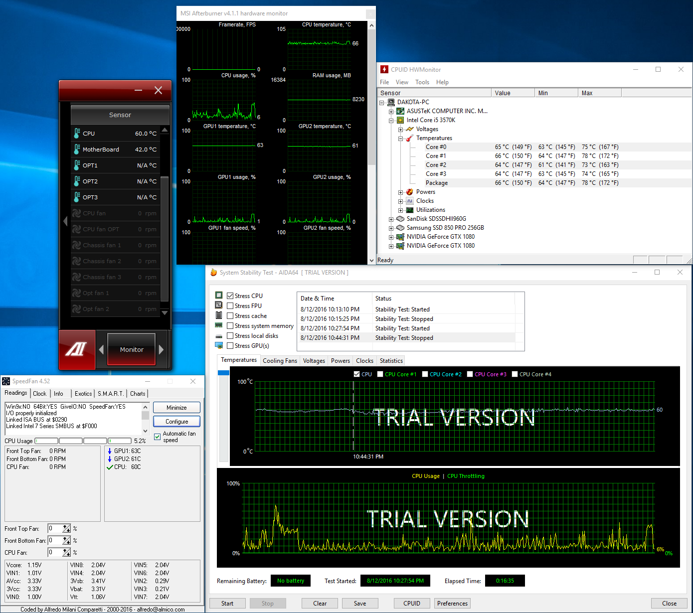

Here's a munch of different monitoring software all running at once:
That's MSI Afterburner, Asus AI SUITE II, AIDA64, SpeedFan, and CPUID HWMonitor. You can see that Afterburner is giving a different CPU temp than the rest of the programs save for HWMonitor which is giving a similar result. This example is pretty tame, earlier I had Afterburner showing nearly +20C than the rest of the programs. I specifically care that Afterburner is wrong since I use the on screen display a lot to check performance. Has anyone ever heard of this or know what could be causing this?
You can set a correction formula (basically an offset) in the Afterburner settings. Just go to Settings > Monitoring > CPU Temp and then change correction formula to something like "x-20". If it's reporting values wrong by an inconsistent amount then this won't help.
Usually a bad sensor, but in this case its hard to say since some are saying 60 and others are around 65-66. In speedfan see if you can see the individual core temps.

Hmm. Seems to have been a complete anomaly. The CPU temp problems I was having as well as other problems I had with SpeedFan incorrectly reading my custom fan controller settings have completely resolved themselves without any input by myself. Thanks to those who tried to help!
