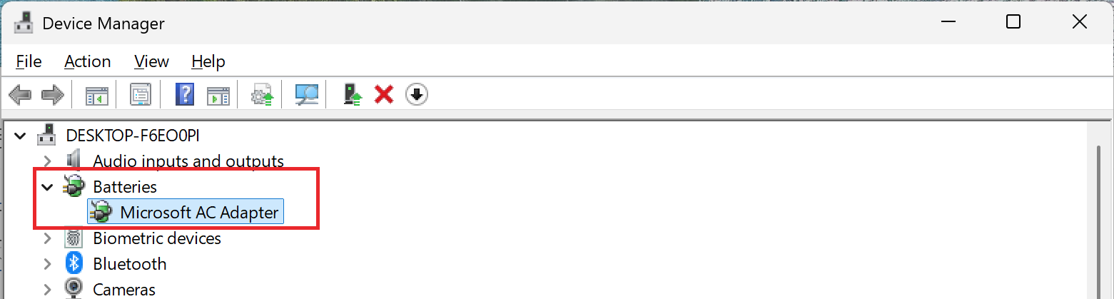

I have just received this MS Surface Pro 5 to do some support - essentially, the laptop does not know what’s going on with the battery (i.e. it doesn’t show up on device manager at all) under Windows 10. I did a fresh install of W11 (because why not) and after installing all the drivers (even though it’s unsupported… Microsoft has drivers available! who knew!). However, the battery still doesn’t show up. I am concerned that there’s something going on with the BMS and that the whole battery needs to be replaced, which is a pain to do on these generation of Surface laptops.

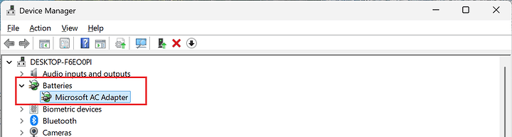

[Screenshot - The laptop just wants to detect an AC Adapter, even though it’s not connected]
My question is: Is there anything I would have to do to diagnose this further? or am I safe to assume that the battery is a fire hazard and that I need to change it straight away?
