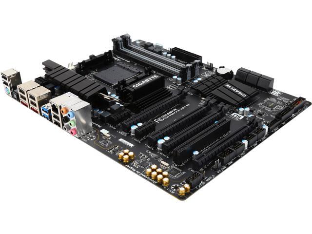

Take the board out and look at the bottom of the board, under the section where the VRM is located. It is not unlikely that you will find a discoloring or burning in that spot. I would recommend you do not attempt to ever boot that board again and replace it with something like this:
http://www.newegg.com/Product/Product.aspx?Item=N82E16813128859&nm_mc=AFC-C8Junction&cm_mmc=AFC-C8Junction-PCPartPicker,%20LLC-_-na-_-na-_-na&cm_sp=&AID=10446076&PID=3938566&SID=
I have the previous revision of this board and it is absolutely awesome. I recommend it 100% It has a proper VRM design and a more up to date feature set, which cannot be said for many AM3+ boards anymore.

$80 after the rebate :3 I mean I would do it personally. You can drop the $80 and re-purpose the computer after you upgrade to Zen or Skylake. FreeNas, eh? eh? Idk, you could make it a virtualization server or do something else fun with it when you upgrade.

Its the previous generation of chipset, which is why it has an iGpu, that has had a bios update to support the newer FX series of processors. I feel bad calling them the "Newer" FX series of processors as they are old as fuck in computer land but whatever. I wouldn't really recommend that board though. Its a 4+1 phase power design, same as your G46, and will also overheat and probably die in a 6 months to a year. The cooling on it is slightly better but its still shite in comparison to a proper 990FX or 970 board, but better than the G43 which is the board that makes me somewhat despise MSI on a petty level.
For reference the G43 is the same board as the G46 but with a 4pin EPS power instead of the standard 8 pin, with no heatsink at all on the VRM. Otherwise its the same board as the G46. The sad part is that Microcenter bundles the 8350 with the G43 for $30, which is why its that much more of a problem.

There are some boards that a tad bit cheaper than the Gigabyte I listed above but none are as good.
If that is the case, I will problably wait untill the morning, see if there is burn marks on the motherboard and see what people have to say about what motherboard to get. Right now Ill probably get the Gigabyte one you listed, but we'll see.
