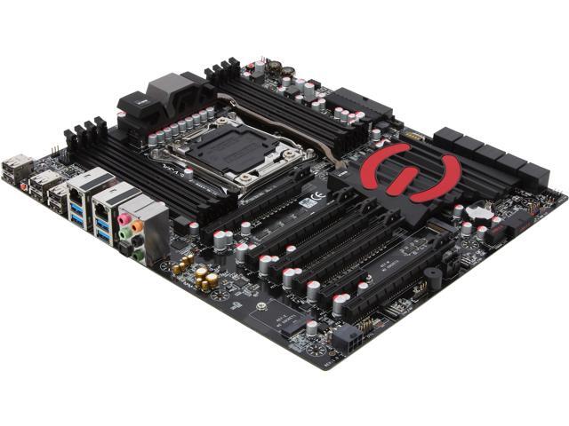

Probably just an EVGA Classified if you can find one, dunno about any of that Xeon stuff though
http://www.newegg.com/Product/Product.aspx?Item=N82E16813188163
It fits most of my criteria, Along with many of the gigabyte boards & some asus boards.
However it is technically not ATX (just a bit longer)
Ive heard of some Asus boards not supporting overclocking the E5-16XX xeons.
And I know some boards are either late or wont support broadwell.
Perhaps I am worrying too much but don't want to end up with a board that isn't going to do exactly what I want.
