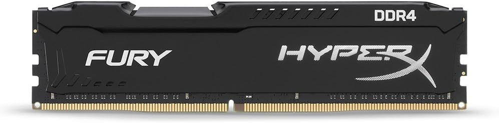

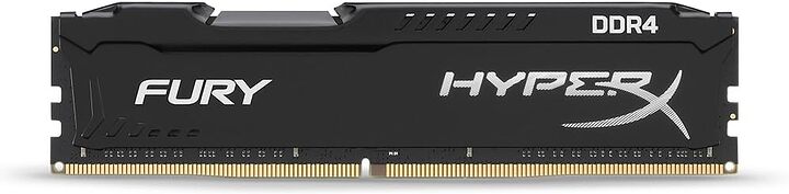

So I have some plans going on for either getting more ram with the same speed or more RAM with faster speeds.
PLAN A:
I have 8GB of DDR4 RAM 2666MHz of Kingston Hyper X. I could get 2 8GB sticks and add upto 24GB of RAM with the same speeds and same brand.
PLAN B:
I can return the current ram (full refund until Jan.31) while the 16GB GALAX HOF 3200MHz RAM starts to ship. http://galaxstore.net/GALAX-HOF-DDR4-3200-MEMORY-16G(8G2)_p_117.html
Which costs $100 plus a $11 shipping fee. Returning the current ram would probably give me $70 back. Typically, I would be spending about $41.
Would you help me lessen the stress on this? Thanks!
