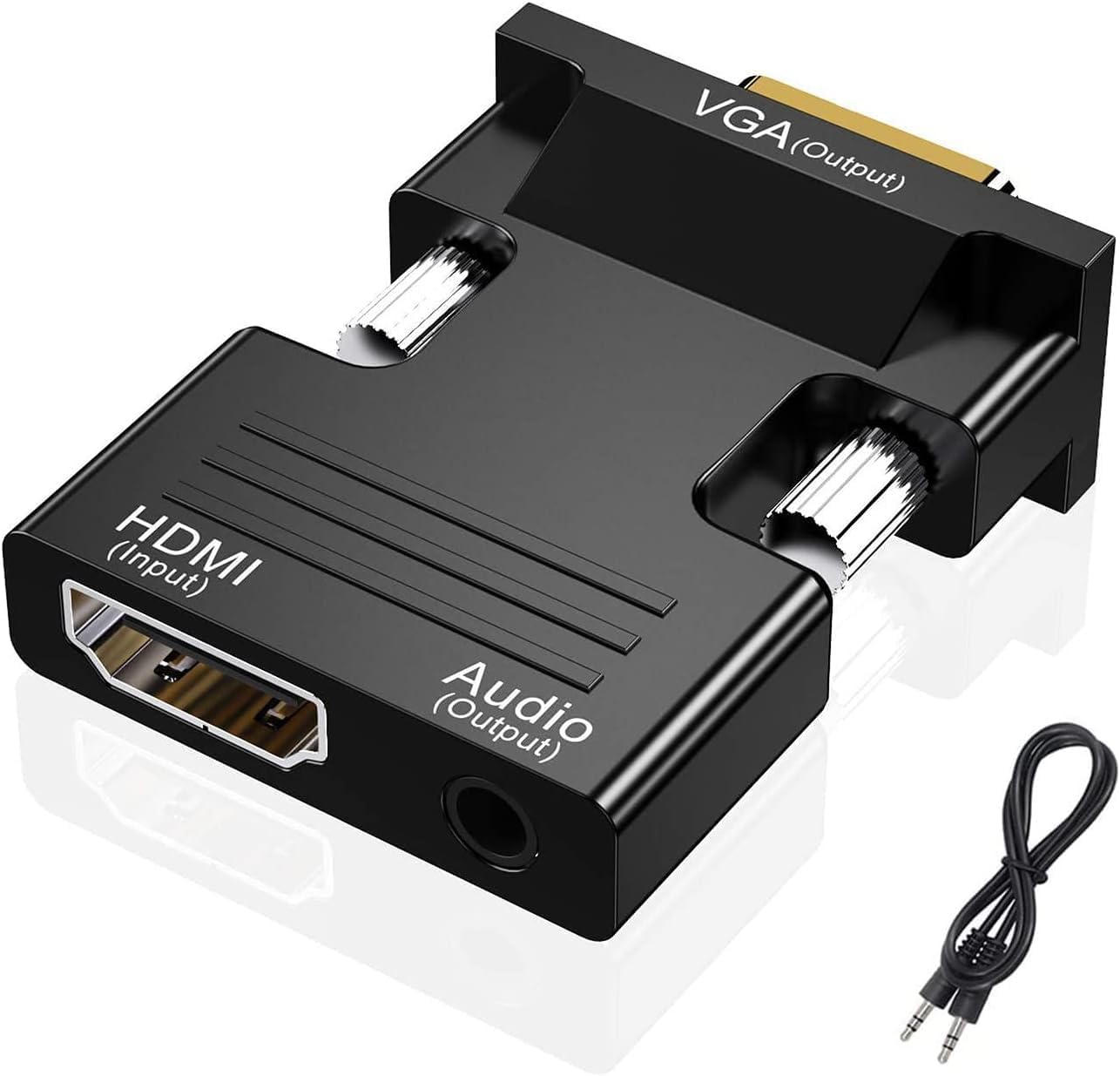

I think what is happening here is that the Screens HDMI is “Sort-of-but-not-quite” HDMI standard, as usually happens when a standard is kinda new.
That is, HDMI Consortium published a standard, vendors started implementing it, bugs were discovered, best practices were changed, and HDMI was slapped on a whole lot of products that, quite frankly, did not meet the standard proper. As time moves on, these almost-but-not-quite HDMI products lose mainstream support and finally kick the bucket 20 years later.
I recommend trying the VGA interface using one of these, this should be good enough to get the screen going:
But for long term, simply replacing the screen with a 1440p 180Hz screen for $175 or so is the best long-term option. This would also provide you with a huge boost for your gaming experience overall. Here is one of many good monitors:
Of course, you know your own situation best here. $150-$200 is a bit to save up for, but this will be plenty worth it. Even then, you can get a cheap $70 1080p screen with 60Hz and 5ms response time that is way better than what you have now. Sometimes it is time to let the past go.

Maybe something cursed like an HDMI to DVI into a DVI to HDMI adapter would help force things to work on an older but still digital level.
Or maybe I’ll go for a more sane adapter.
