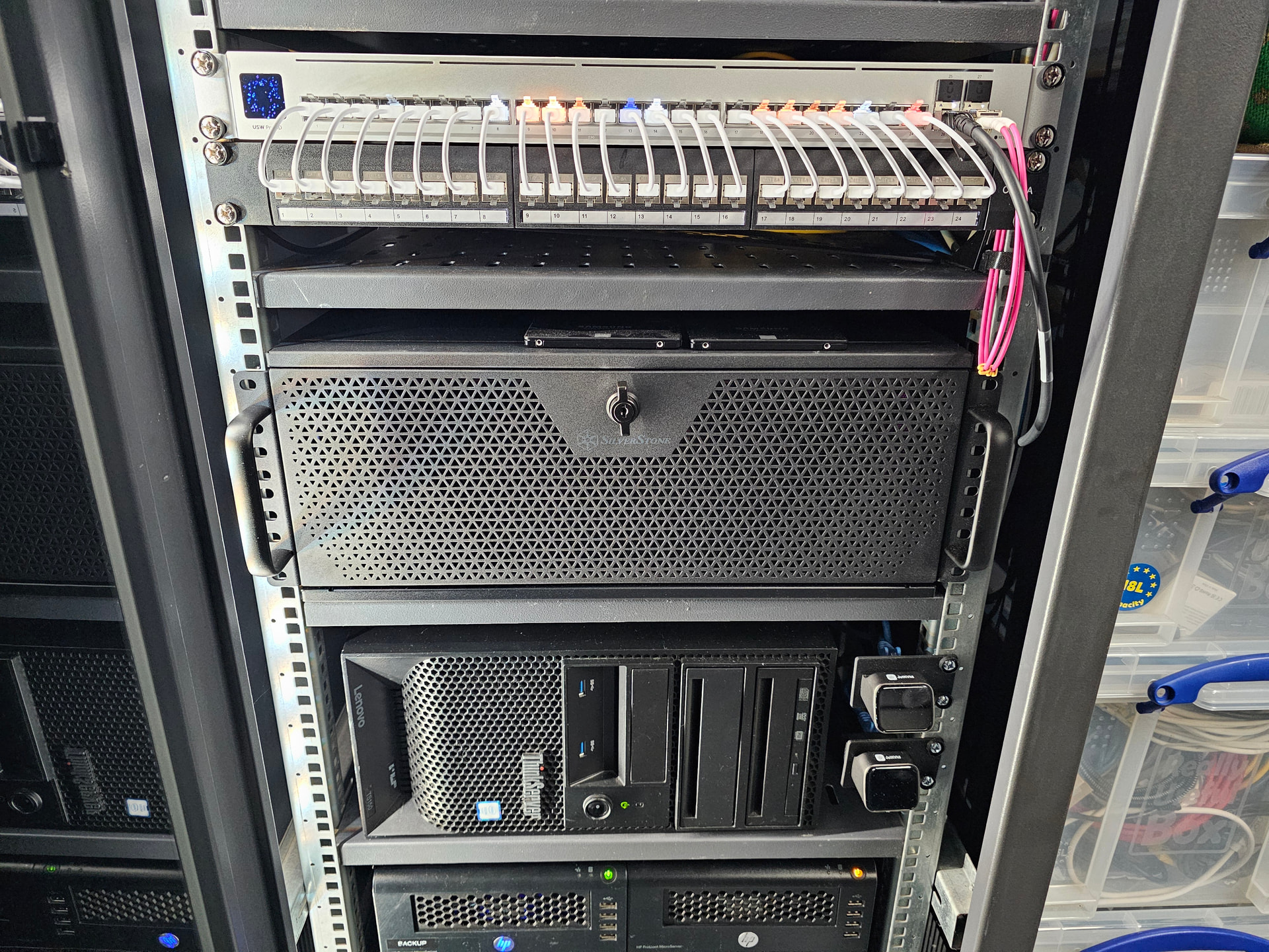

Pic of my RM44 just because I love it

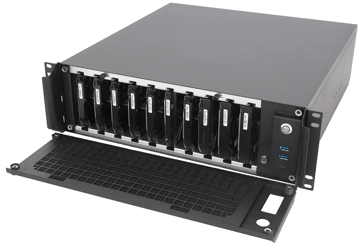

This is actually a contender, the Sliger CX3702
$100 Fedex to the UK (or free for those of you in the States) AND it’ll fit in a network rack.
