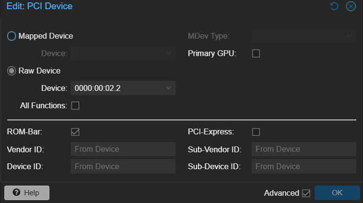

I then created the two VMs each connected to a seperate VF for Jellyfin and Frigate. Using them individually runs fine however when both hit the iGPU they both run into issues. The following are the errors that Jellyfin,Frigate, and the Proxmox host itself report during the “incident”

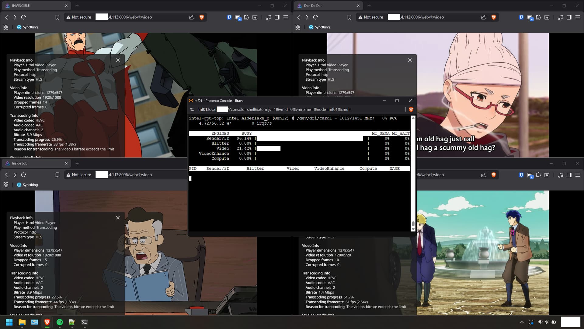

I created two VMs for testing. Each connected to a different VF. Each VM is running Docker and has a Jellyfin container. The VMs are using NFS to access my media server(TrueNAS).
On each Jellyfin instance, I configured transcoding and started two streams per instance. each stream is a different show and at different quality. I wanted to see if it would break. Good news! It doesn’t. All streams work without issue and the proxmox host reports no errors. So in terms of running many jellyfin instances using different VFs, this works.
Here’s some proof.
The next test will be running Frigate on a VF and see if issues occur. I’ll report back when I run those tests.

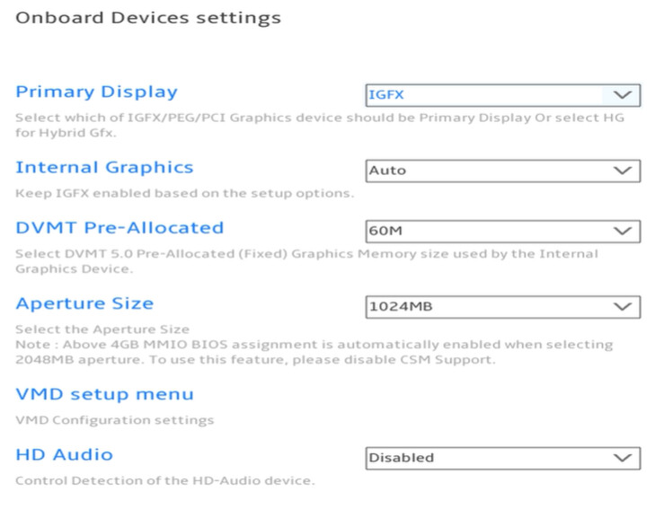

I suspect this might be caused by a BIOS setting I changed in a previous test of VF/i915. Therefore I went back to the BIOS and changed the Primary Display setting back to IGFX
Let’s see if this resolves the issue.

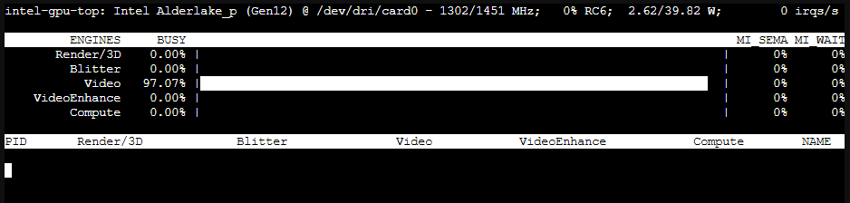

One thing I noticed is that in your screenshot of intel_gpu_top your VideoEnhance wasn’t showing any activity - not sure what that actually represents, but in my case, when I’m transcoding a 4K HDR video I have
  • 44% render/3D
  • 43% Video
  • 98% VideoEnhance
Not sure if this’ll help:
BIOS → Onboard Devices → Video (or maybe primary display?) → Hybrid
But in my case I use the Intel vPro interface (via mesh commander) and the HDMI output of my MS-01 has a cheapo dummy plug.
@shadowimmage
I had the “Primary Display” set to Hybrid. I changed it now to IGFX to see if that helps with the issue I am having. Why does it need to be set to Hybrid?
I have dummy HDMI plugs so I can test removing the KVM. I’ll give it a couple hours and see if it crashes again before making more changes.

It appears to me that the iGPU is at its limit but I need to investigate more to be sure.

The current version of the driver scheduler is not very intelligent.
Jellyfin tends to use the entire GPU
I’ll implement this change and let the system sit doing nothing. See if the crashes occur again.

Heyo,
I’ve been looking into this further and have reached some conclusions. I initially blamed Jellyfin for the issue, but after discussing it with a developer on a GitHub issue, I’ve learned that the problem is actually driver-related.
A temporary workaround can be applied—such as using a wrapper to limit FFmpeg’s read rate—but this isn’t a permanent solution. So the high resource usage in Jellyfin appears to stem from the driver not handling this properly.
I hope the developer of the i915-sriov-dkms project sees my issue and can provide some insight.
Stay tuned!
Heyo Reader,
The issue I mentioned earlier has been resolved! With the help of the creator of i915-sriov-dkms, we were able to track down the cause and create a fix.
Recap:
Whenever Jellyfin started a transcoding job, it would greedily consume the entire GPU, which interrupted other GPU-dependent services — in my case, Frigate.
Solution:
We used a wrapper script to apply a readrate limit to the ffmpeg process launched by Jellyfin. This prevents Jellyfin from monopolizing the GPU and keeps everything running smoothly.
You can find both the wrapper scripts and the docker-compose file I used in this thread.
A note from the creator. This issue will never be permanently solved as support for i915 has ended. We need to wait for kernel 6.18 and proper Xe support.
Validation:
I confirmed these settings work and are stable by running multiple video streams from Jellyfin, Frigate, and Windows (RDP). The system has been up and stable.
And with that, the problem is solved! I hope this helps someone else down the line.
