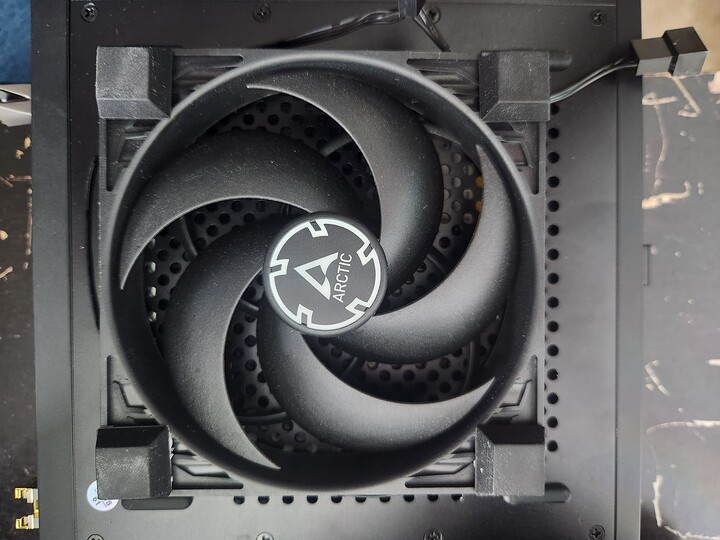

I used some M3 screws to attach a 120mm Arctic P120 fan to the bottom (extra credit, I used the fan with the “PWM sharing technology” (daisy chain):

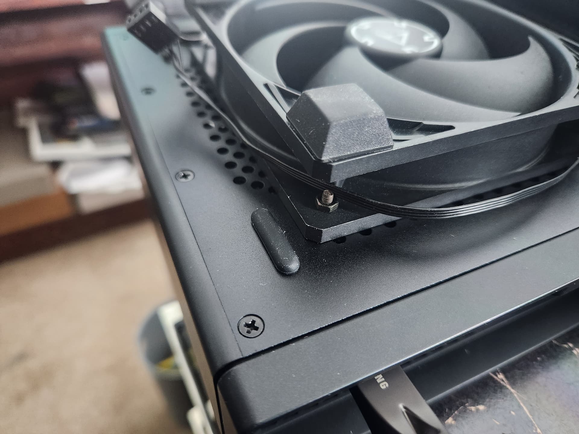

For those like me, you can square the fan by attaching at two diagonal holes.
Add the rubber feet to the bottom of the fan and you get a quiet (and cool) running MS-01.

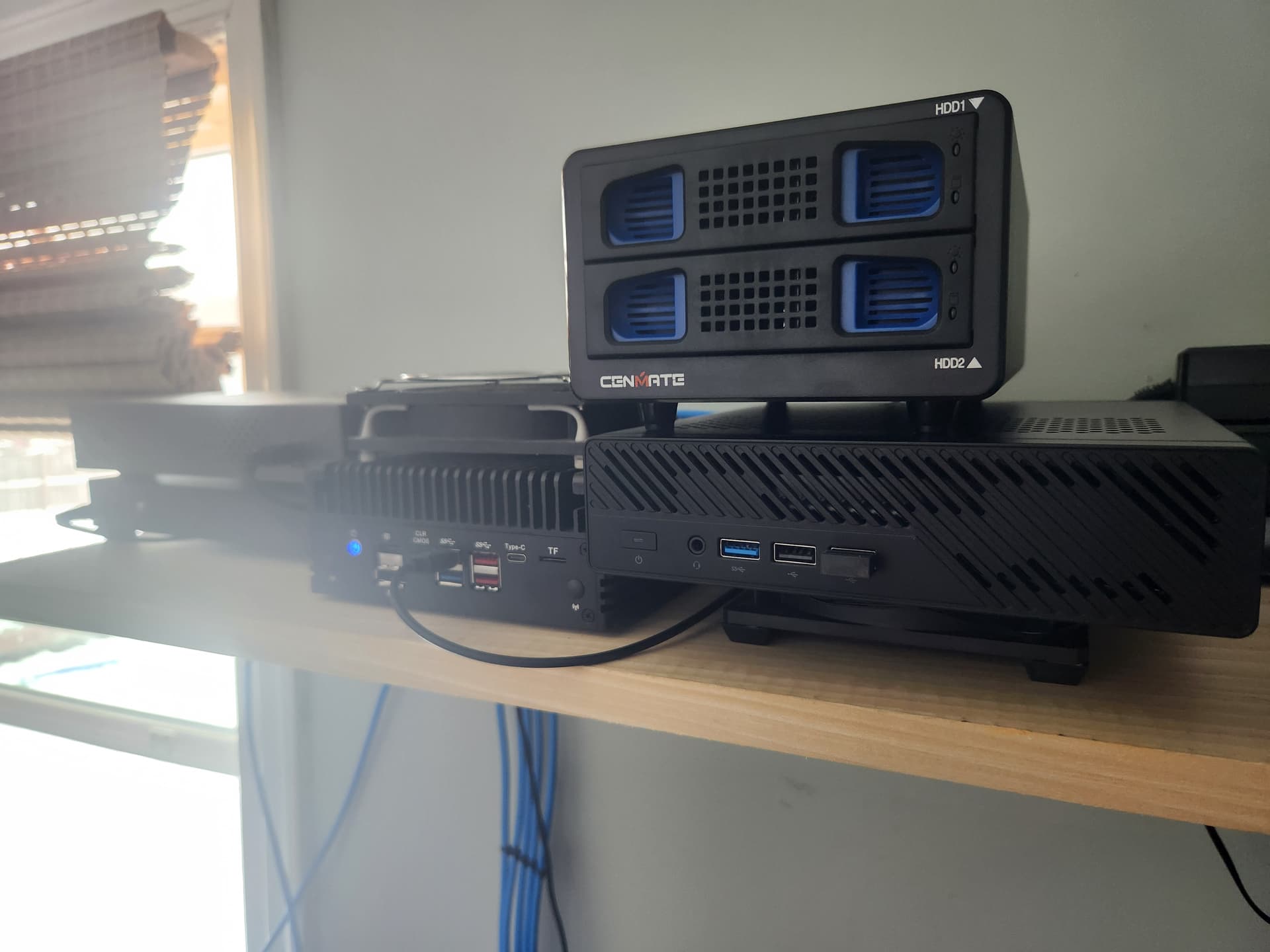

I used the daisy chain to add a fan on top of my “fanless” firewall PC.
