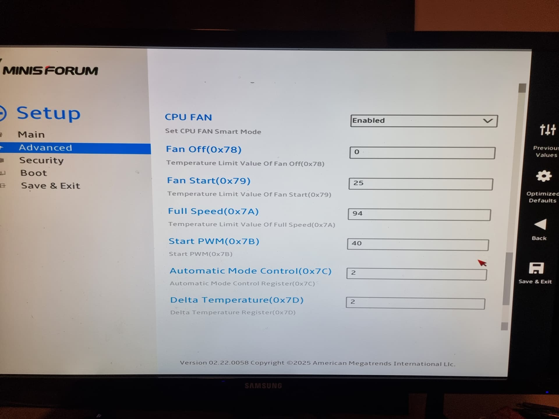

Hey Guys,
i bought the Minisforum BD795i SE. I want to control the fans a bit to reduce the idle noise under load i dont care anyway. But now the Bios hits me with this?
Thanks in advance i am sure here are people that are smarter than me.

I’m struggling with fan control as well. My CPU fan runs at idle or “full speed” with no in between.
I think start pwm is meant to be a pwm value rather than percentage. PWM value is usually out of 256 values starting at 0, ending with 255.
Automatic fan control and delta temperature I don’t understand.

I have the MINIS FORUM BD795i SE and spent some time tinkering with BIOS settings for fan control. HWiNFO reports that the board uses an ITE IT8613E internal fan controller. This chip supports 3 temperatur sensor sources including one internal sensor. HWiNFO reports these as follows:
“Temperature 1” - this appears to be the internal sensor
“Temperature 2” - this sensor roughly seems to track SOC VRM temp
“Temperature 3” - CPU die temperature (Tctl/Tdie)
HWiNFO recognises 3 fans controlled by the IT86xx:
“CPU” - this actually corresponds to the MinisForums “SYSFAN2”
“Power” - this shows “SYSFAN”
“Fan4” - this is the actual CPU-Fan.
So far so confusing. Frustratingly, sensors mapping to fans is fixed:
“Temperature 1” controls SYSFAN2
“Temperature 2” controls SYSFAN
“Temperature 3” controls CPU FAN
While mapping “Temperature 3” = Tdie to the CPU-fan makes sense, the other sensors need a little more analysis:
  • “Temperature 1” has a range of about 25° to 40°
  • “Temperature 2” has a range of about 27° to 50°
Now let’s take a look the the BIOS parameters for fan control:
“Fan off”: if the temperature falls below this value at which the fan switches off.
" Fan start": if the temp exceeds this limit, the fan switches on.
“TFull Speed”: if this temp is exceeded the fan goes to max RPM
“Start PWM”: this defines the RPM at which the fan start when reaching “Fan start” temp
(range: 0 - 255 which 0 = off and 255=max RPM)
“Automatic Mode Control”: this parameter appears to define the RPM slope between Start RPM and max RPM. I seems to accept values from 0 to 63 with 0 defining no slope and 63 defining a more smooth increase of RPMs between Start and Max temps.
“Delta Temperature” defines the number of degrees delta for a change to happen.
As a starting point for experimentation you could use the following values:
“SYS FAN2”
  • Smart Mode: enabled
  • Fan Off: 0
  • Fan On: 30
  • TFull Speed: 40
  • StartPWM: 64
  • Auto Mode Control: 63
  • Delta Temp: 1
SYS FAN:
  • Smart Mode: Enabled
  • Fan Off: 0
  • Fan On: 30
  • TFull Speed: 50
  • StartPWM: 64
  • Delta Temp: 1
For some reason the “Automatic Mode Control” for the “CPU FAN” seems to require much lower values for a smooth slope than SYS FAN2 and SYS FAN. Values higher than 3 of 4 lead to excessive RPMs even at lower temps.
I hope this helps
