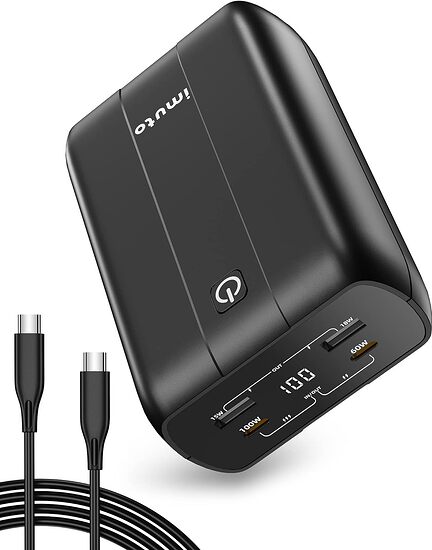

These work for sure:
couldn’t find the same exact model on the US site … in theory anything with these specs should work. This exact model is what I use for my Macbook Pro M2 …
