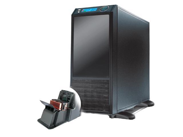

May not be a mini fridge but this is what i was picturing.. just making the fans run along with water cooling setups would make this A+.... just have fun paying electrical bills hahaha.
Yeah see that's the setup that wouldn't work , and has been shown to not work.

http://www.newegg.com/product/product.aspx?Item=N82E16811221001&nm_mc=AFC-C8Junction&cm_mmc=AFC-C8Junction-VigLink-_-na-_-na-_-na&cm_sp=&AID=10446076&PID=6146846&SID=ieuy5bb765000kb500053
