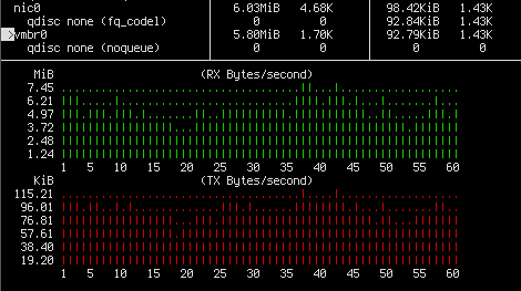

Small peek a the performance.
I didn’t really set out to do proper benchmark but this may illustrate the works case scenario.
In this case I’m uploading ISO to proxmox server over rb5009’s tailscale subnet router container.
In my current network setup Because of my network topology, only way to establish that network connection is via tailscale relay.
Here is the bmon network interface speed graph from proxmox server:
20260216_21h05m13s_grim-2
And here is rb5009 cpu usage
20260216_21h05m13s_grim-1
Normally CPU usage is close to zero even when proxmox was directly downloading ISOs from the internet (with basic routing , firewall and NAT running on the router)
I don’t remember if tailscale relay traffic uses significantly different network packets than normal wireguard for direct connection. Tailscale peer relay posts have overshadowed all older posts about how relay traffi works.
In this case CPU speed was switching between 700MHz and 1400MHz. It may be possible to squeeze more permance out of this setup, but ~6MiB/s (~50.331648 Mb/s) with 50% CPU utilization doesn’t look exciting.
In this scenario speed is mainly bottlenecked by tailscale relay server handicap. But CPU utilization is still quite high for what what it gives you.
