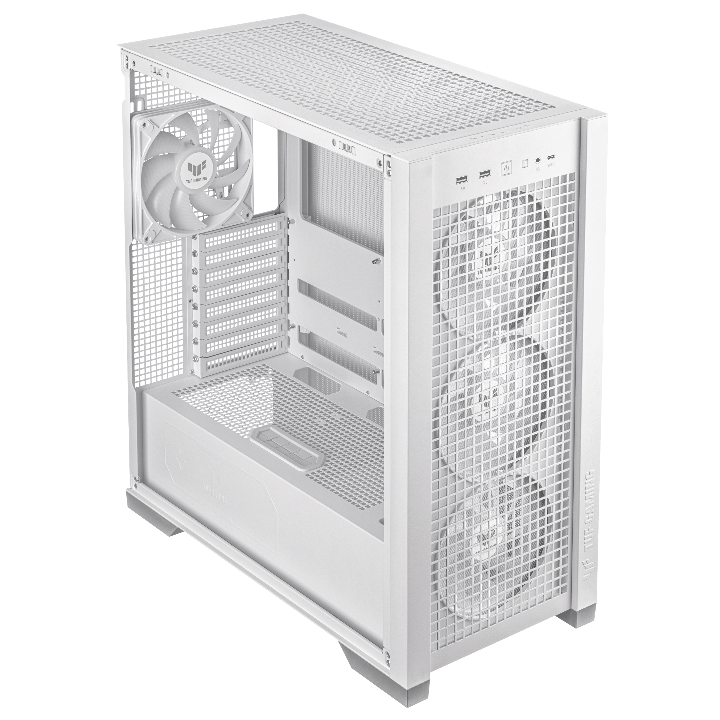

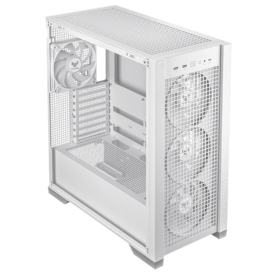

Found Asus GT302, although it has rgb and glass which I don’t like, it does have 8 pcie slot, and decent air flow.
