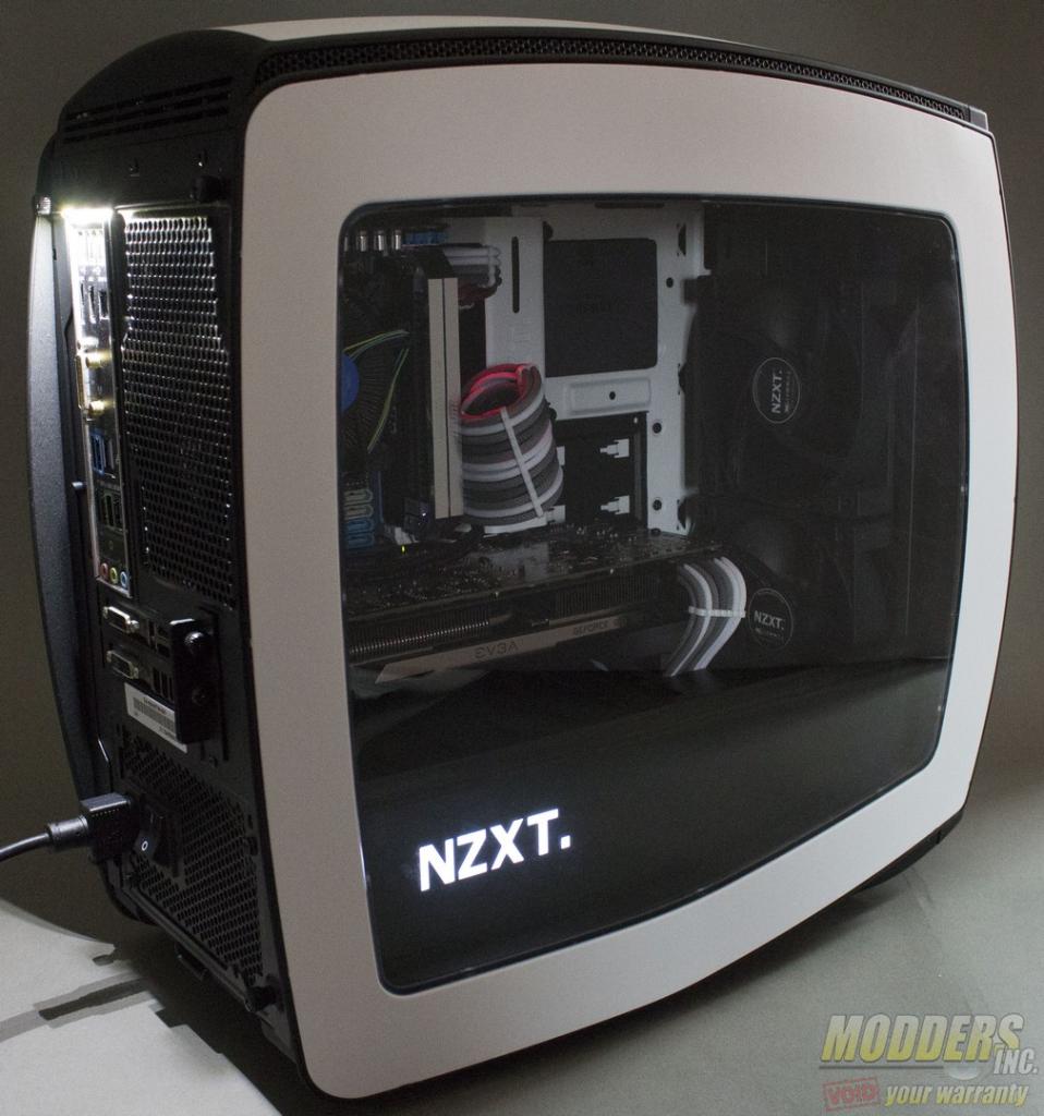

While the NZXT case is nice, its overly bulky and just looks odd imo. The HAF stacker is also not what I'm looking for
