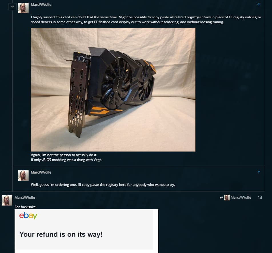

I highly suspect this card can do all 6 at the same time. Might be possible to copy paste all related registry entries in place of FE registy entries, or spoof drivers in some other way, to get FE flashed card display out to work without soldering, and without loosing tuning.
Again, I’m not the person to actually do it.
If only vBIOS modding was a thing with Vega.

Well, guess I’m ordering one. I’ll copy paste the registry here for anybody who wants to try.
