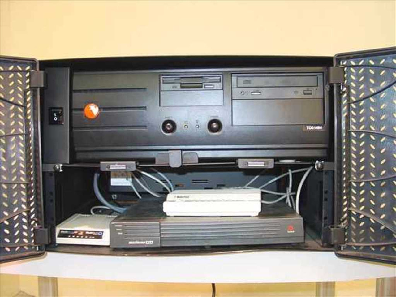

I have an old steel VTEL case (something like above) with a little rust that’s never caused a problem various motherboards for years!
Not sure where it came from originally, but I got it from a friend early 2000s :stuck_out_tongue:
