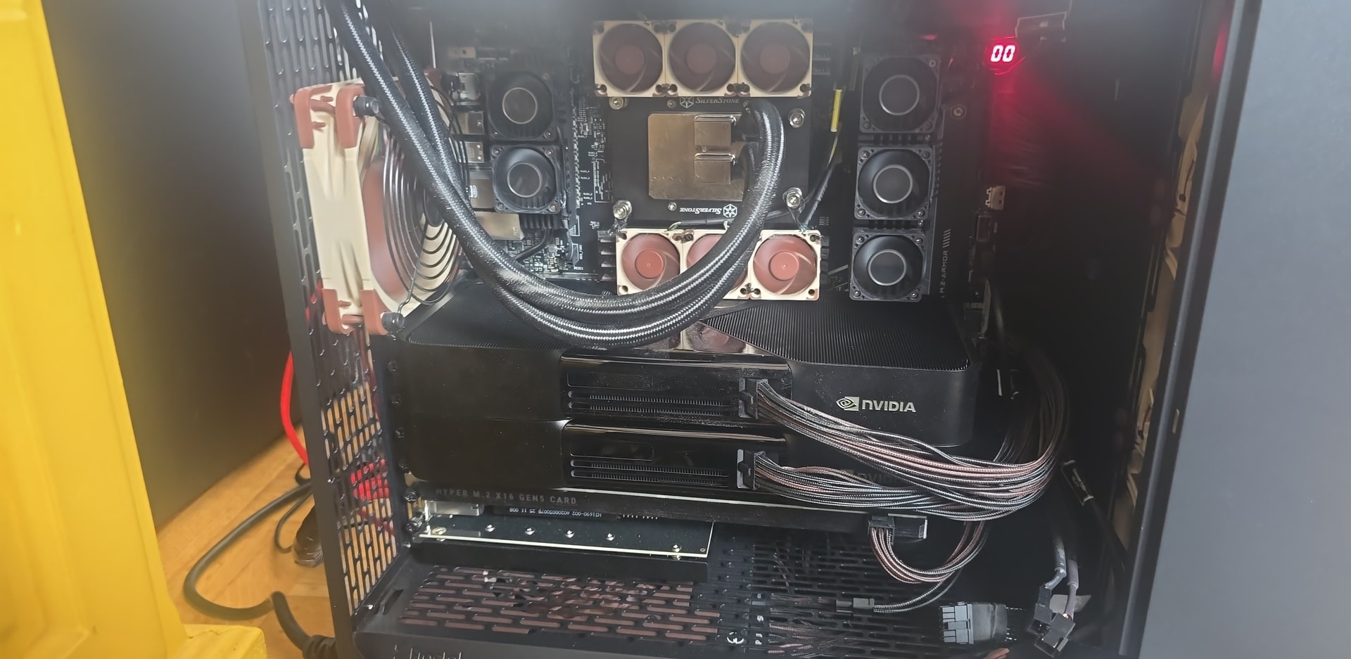

So, I built this and it’s great with two 600w workstation cards. I spent a whole lot on it though.
I don’t regret any decisions, but living in the US, 1600w PSU seems dicey. I don’t have a 220v outlet in my whole rental house so I can’t even find an UPS that will work with this rig.
In short, I probably should have gone max q, and I’m now limited to what I have and can’t add any more cards, even if I wanted to at this power limit.
