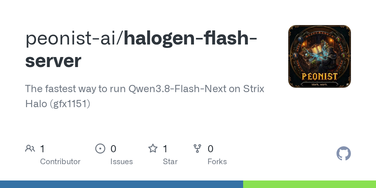

I ended up building an inference engine tailored to the Strix Halo and Qwen 3.8 architecture… It turned out being about 2x as fast at prefill as the next closest engine I could find at higher model weights. >550t/s @32k depth. There might be a little more room to go but it is approaching the wall of physics and my hardware can’t run past 2400Mhz under load. If you have good cooling and can hit closer to the 2900MHz clock, you can probably push 600+ @32k context depth.
Anyway, I wasn’t going to release this, but decided if even a few people find it useful and it saves them time its worth it.
I tried to make it as simple as possible to just fire up a server and run it. The instructions are in the repo. Model weights on hugging face.

repo is at github / peonist-ai/halogen-server

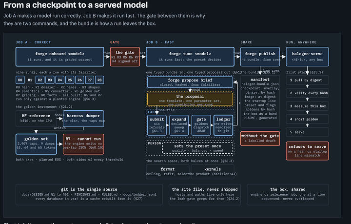

Hi! Yes. I am working on open sourcing not just the engine but the methods with a harness for kernel auto tuning. Stay tuned.

Hi! Flattered. Thank you for the offer. I will take you up on that right now. What do you think about this architecture?

I am working on the harness, which will include all of my findings across the 27B and flash model for qwen 3.8. I think this is the important work that resulted from halogen and not necessarily the kernels.
