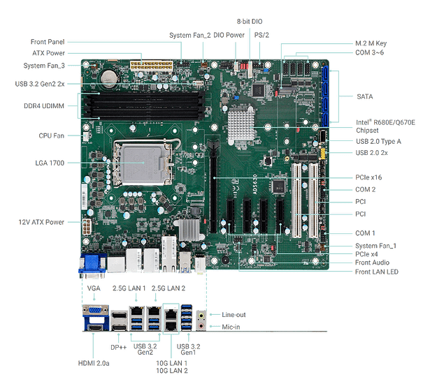

There are boards like the ADS630 that support PCIe x16+x4+x4+x4+x4+M.2s+on board 10GBe but I think this might be overkill with PCIe slots and features (also kind of expensive @ 700USD).
