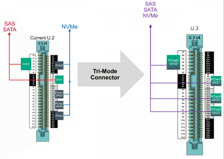

I did do some more ´research´. The upcomming U.3 standard should support ´tri-mode´ on the same SFF-8639 connector (SAS, SATA and NVME) and has its data pins shuffeld. Where in U.2 the SATA(SAS0) and PCIe channels are actually on separate pins, in U.3 the first PCIe lane and the SATA lane are overlapping (like in M.2). With U.3, hot-swapping between SATA and NVME actually is a possibility, and this standard appears to be invented to exactly solve the problem I want to solve here.
Inside the M.2 connector the SATA and PCIe0 lanes are on the same pins, triggered by a pin that switches between SATA and NVME mode (so this will never work on a hotswap bay that doesn´t have the trigger pin, not even U.3 would work even while the data pins of SATA and NVME do align with M.2).
Eg. M.2 to U.2 or U.3 with SATA+NVME mode would never work because the enable SATA/NVME pin is never triggered correctly.
Only way remaining for now is one of those injectors that injects SATA+NVME into U.2 (because in U.2 the NVME and SATA data pins are actually separate physical pins, in contrary to U.3).
