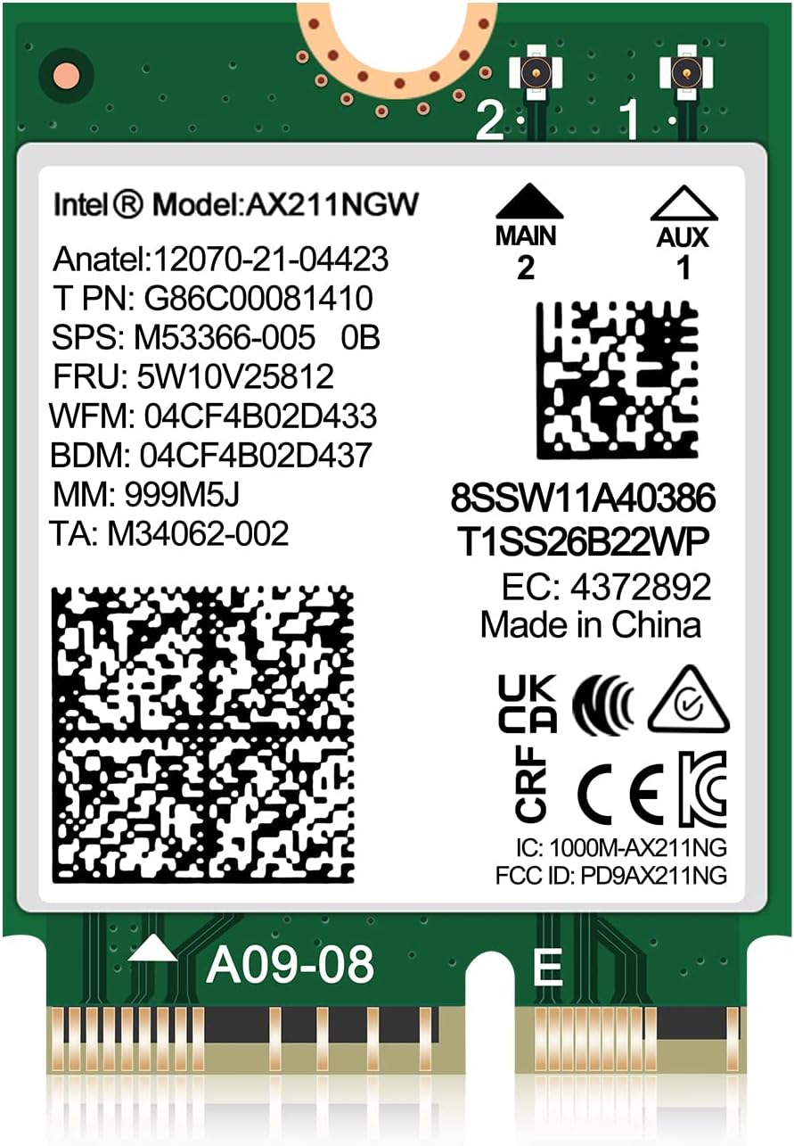

Hmm, it seems like you are correct - there are E to M port adapters but I cannot find M to E.
That said… One solution could be to buy a proper WiFi module with E key instead?

That’s a wireless card…
